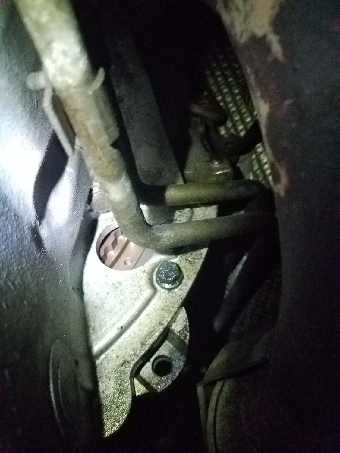

flex plate exposed
there are two holes like this. Maybe just freeze plugs that weren't replaced? how big of a deal is this? Do I need to service anything in particular? truck drives great and has been like this for 1000s of miles...

there's little rubber plugs that go there. Sorry but can't remember the name of them. Check L8 or AB.

Here you go Oil Pan Grommet (Rear) (Genuine Part # ERR7229 ) - Land Rover gaskets and seals from Atlantic British

Fantastic!
Thanks to the both of you. Relieved it's an easy and cheap fix
