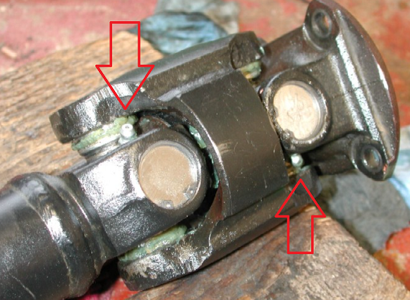

That looks like an OE LR Drive Shaft with greasable MOOG 344 U joints.
Not really the strongest U joint on the planet( OK for on road/DD). And not a fan of those long zerks. With the drive shaft/suspension fully articulated (like with a lifted truck) they tend to hit the drive shaft yokes (don't ask how I know this ).
Those zerks should also be in the opposite direction/phase of each other.

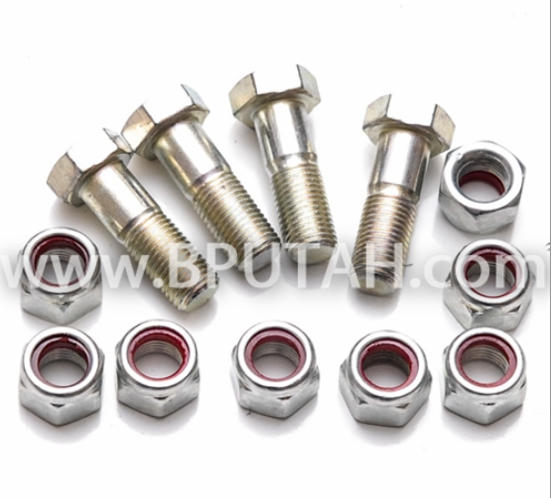

You might also want to grab some new drive shaft bolts and locknuts. It's a good thing to do, plus the nuts @ the transfer case look like they are starting to round off.
The bolts are 1 1/8" X 3/8" UNF(don't use coarse thread hardware) part #509045P and the nut part # NZ606041L. You can also get a complete hardware kit (DA1123) > Range Rover Discovery Defender Driveshaft Drive Shaft Bolt Nut

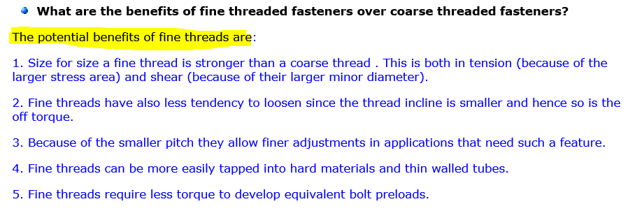

Any particular reason not to use coarse thread hardware? I've got grade 8 3/8" coarse at both diffs.
Old Dec 10, 2017 | 09:44 PM
OverRover's Avatar
Posts: 2,514
Likes: 656
The simple answer is a fine thread bolt is stronger than a coarse thread. I'm not going to bore you with details that are an easy search on google. The pic is just some real basic info.
For years I have only used fine threaded hardware for drive shafts on LRs and other vehicles that have a ton more horsepower and torque. Are you going to be fine with coarse threaded hardware, probably but my 1st choice is fine threads.
