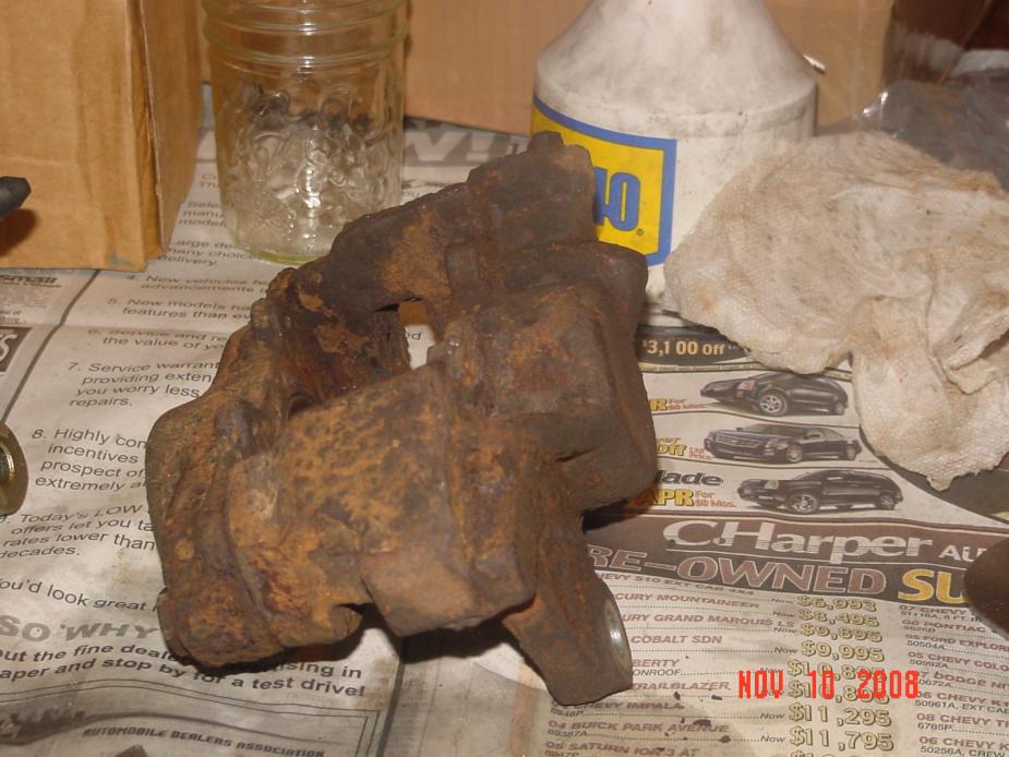

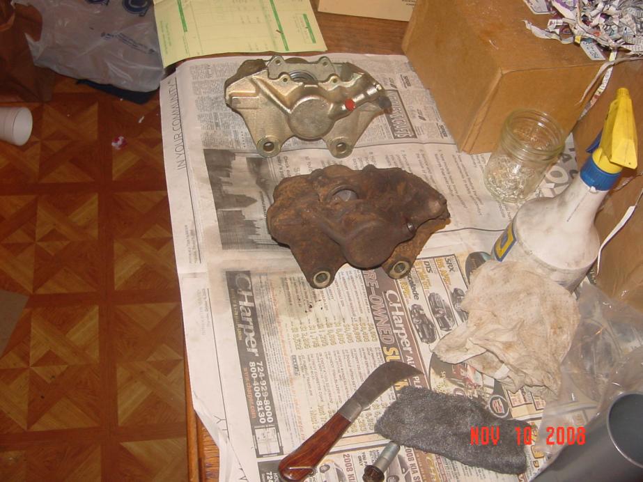

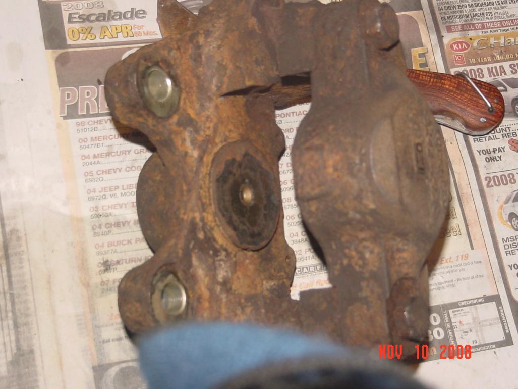

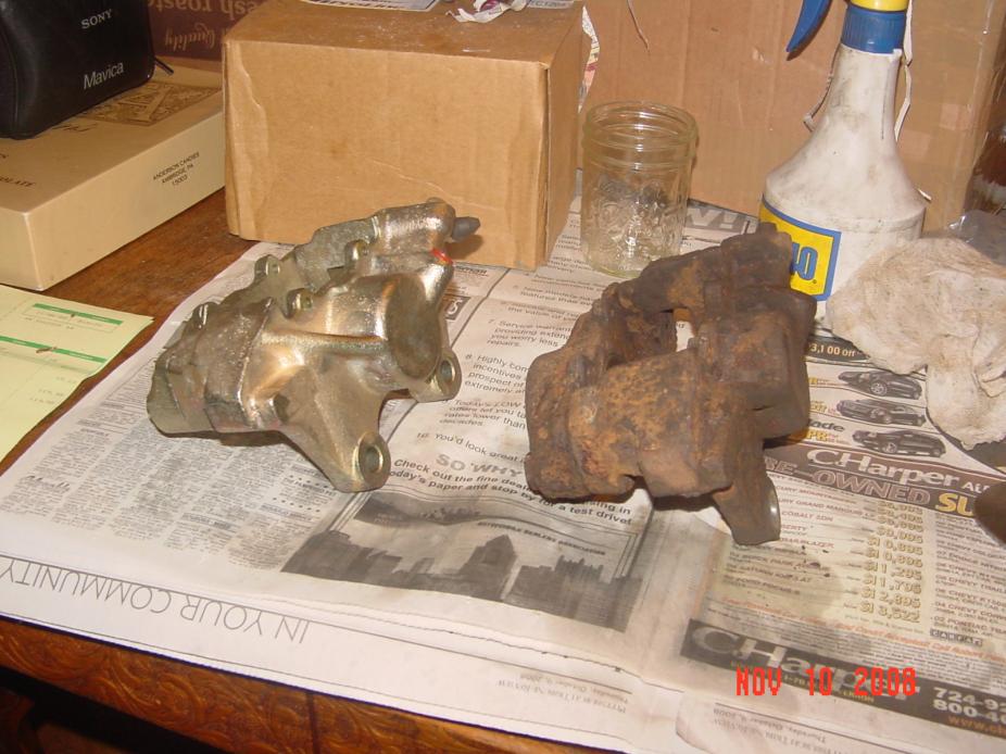

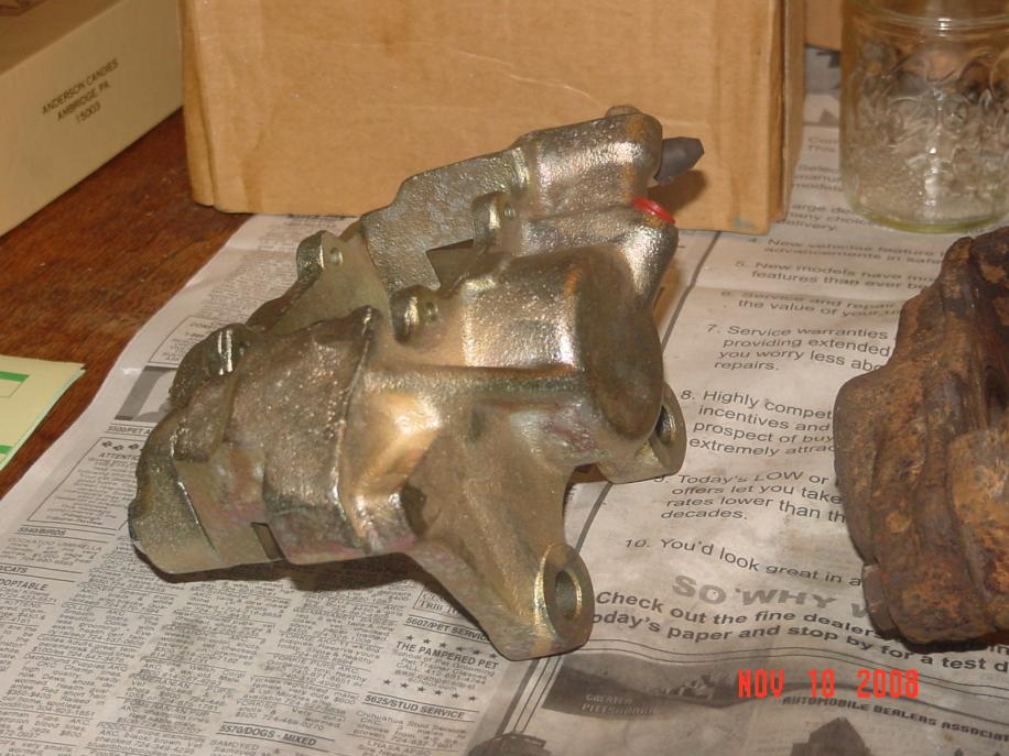

I changed the rear brake clipers on my 97 DI about two years ago. I just remenberred I have some good pics of old and new calipers. Old were the original LR, new are ProLine from Rovers North. Take a look. One of my old ones was so corroded, one mounting bolt sheared. I burned up a Dremel tool cutting the caliper in half with a carbide blade. I ended up beatin it apart with a mini-sledge and a chisel. What a blast that was.
I like the new ProLine caliper with its chem finish. Price was righteous compared to OE. Your caliper piston is probably dragging. The ProLine Caliper new is only a few bucks more than parts to rebuild originals, and they are direct replacement bolt-in. NICE ONES.
