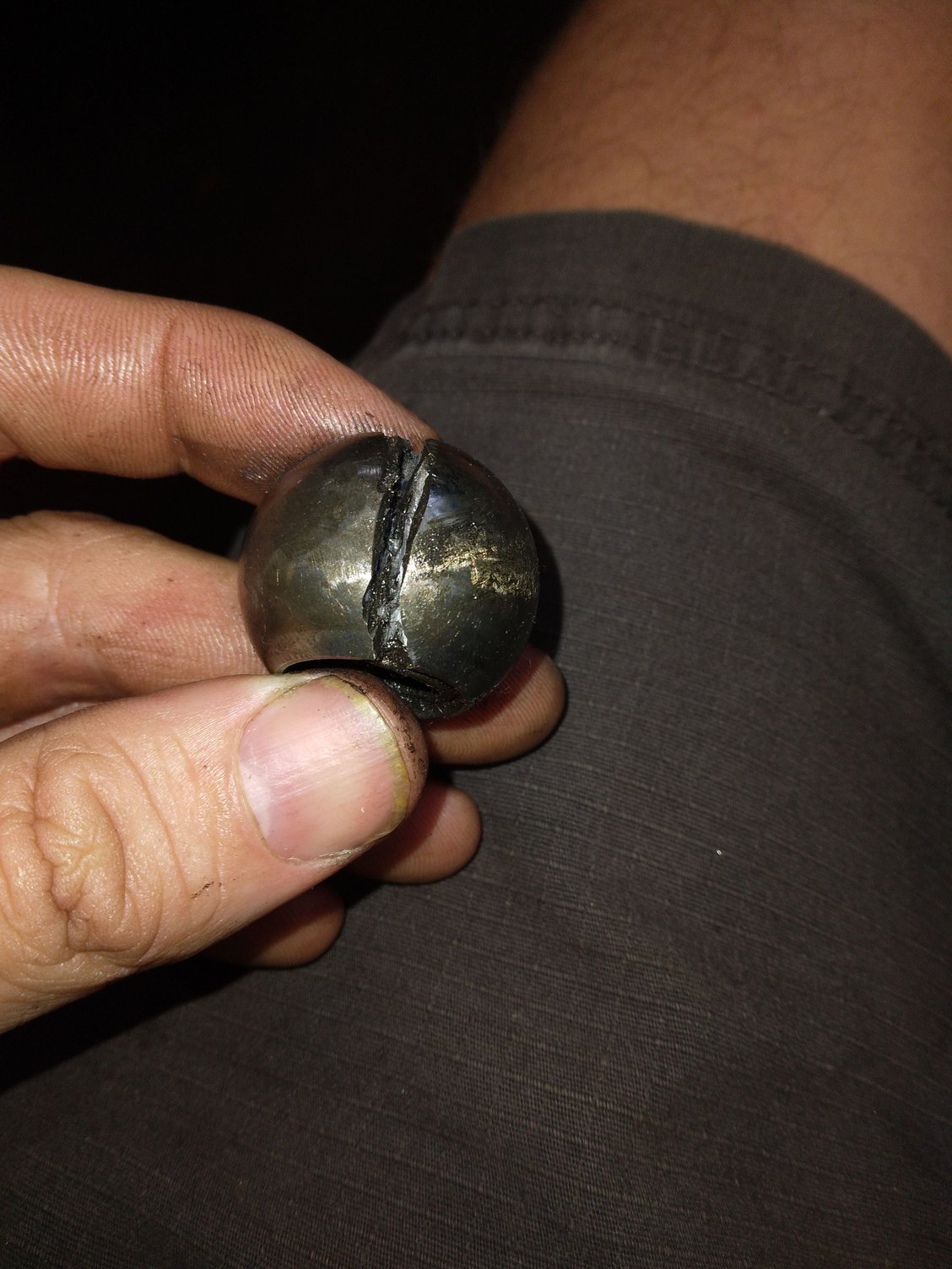

a little slice across the ball allows for easy removal. I don't own or feel like fighting with a slide hammer. I do have a die grinder that I'm good with. Maybe a 15 min removal once the u joint was pulled.

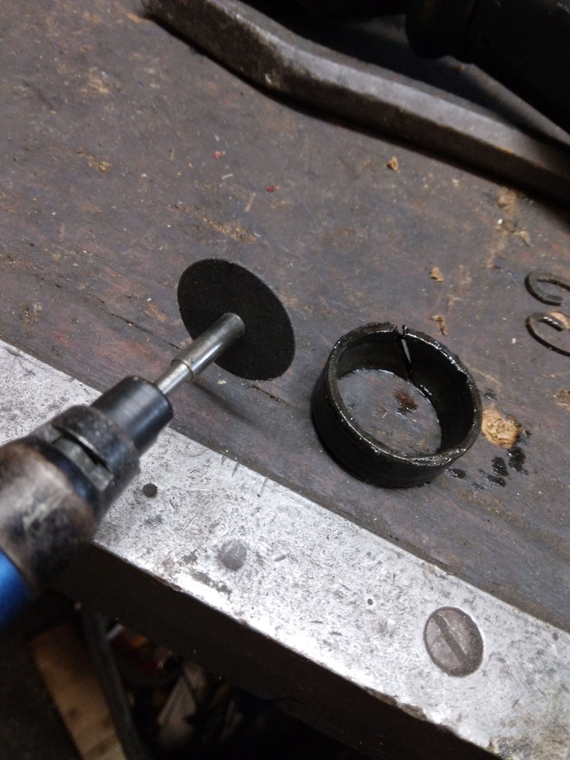

to handle the inner race my pneumatic dremel came to the rescue. This is hardened steel so that means it's brittle. You only need to make a slice 90% through. Once done a good wack with a punch will crack it then pull it on out. You don't want to grind into the housing.
