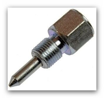

To grease a low profile zerk you do use a needle fitting, but one with a larger angle tip. It's wide enough to cover the ball bearing in the fitting. You can get them at Napa, AZ, Advance Auto( #LIN5803) McMaster Carr, etc or online. They also come in different lengths.

A seal-off needle fitting will also work for grease plugs/low profile zerks. These come in different lengths and diameters too.
Like this > Performance Tool W54214 - Dispenser | O'Reilly Auto Parts_
