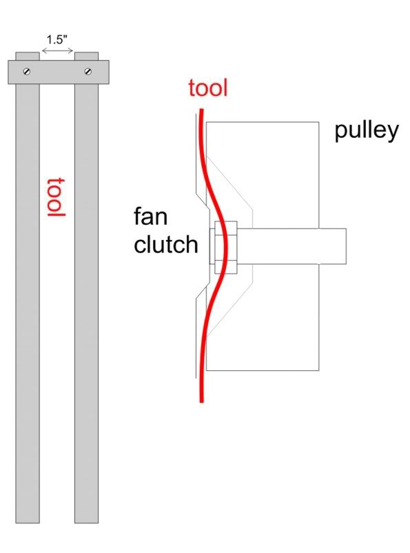

If you are going to trash it you should try both these things first:
1. Mount the assembly on the engine or in a vice.
Then get a drill with a rubber sanding pad on it (no sanding disc).
Run the drill with the edge of the pad on the pulley ? I think you need the pulley running clockwise viewed from the front.
Let the assembly spin up and then apply some resistance to the front of the fan ? use a brush or broom.
This might offer enough resistance to unscrew the fan clutch. If the resistance is not enough apply heat to the coil while it is spinning. Then apply resistance again.
Unless you are an octopus you are going to need a couple of friends to help you with this.
2. If the first thing doesn?t work and there is a millimetre or so gap between the pulley and the fan clutch you may be able to make a tool to grip it. make it out out a couple of strips of thin metal - it should flex enough to find the nut! place the tool around the assembly and force the edges into the gap (like scissors). once you have it in just grip it closed and try and unscrew the pulley.
if neither of these work I'm all out of ideas!
Good luck!

I am certain that I will hafta trash the pulley - its the cheapest part among them. I plan to put the pulley into my vise and drill 2 holes at 3 and 9 o'clock in the edge (i.e. the part that the belt rides on) and then use my dremel to cut the pulley to connect the two holes. Then cut fromo the 3 o'clock and 9 o'clock holes to the inside edge of the pulley (i.e. toward the fan) making a large section of the pulley cut-a-way. The idea is to get the fan unscrewed. I am willing to sacrafice the pulley to get it apart. I assume that welding the pulley back together is a bad idea? or just buy a new one, hopefully from the junk yard.
I dont see anyway to fab a piece to fit that little slot. not nearly enough room to work inside there.
