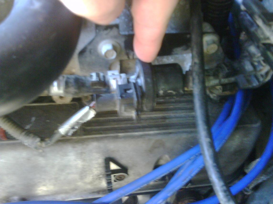

the RAVE manual mentions a purge valve that sits somewhere above the valve cover.
Which side is it on? Since it is one of the things that I disconnected and reconnected a half dozen times in the process of this adventure I will go out in this evening and see if it is a: hooked up at all and b: clean the connections for it and plug it back in.

Is this the purge valve?

Yes that is it.

ah ha! I found it! I feel very successful now and I was due for a success. Anyway, I will go out tonight and take it off the truck, clean it up, and reconnect it. I burnt off all the old fuel and it is still stalling out badly under any kind of acceleration. Its making me poopy to be this close to complete success and still not making it...
