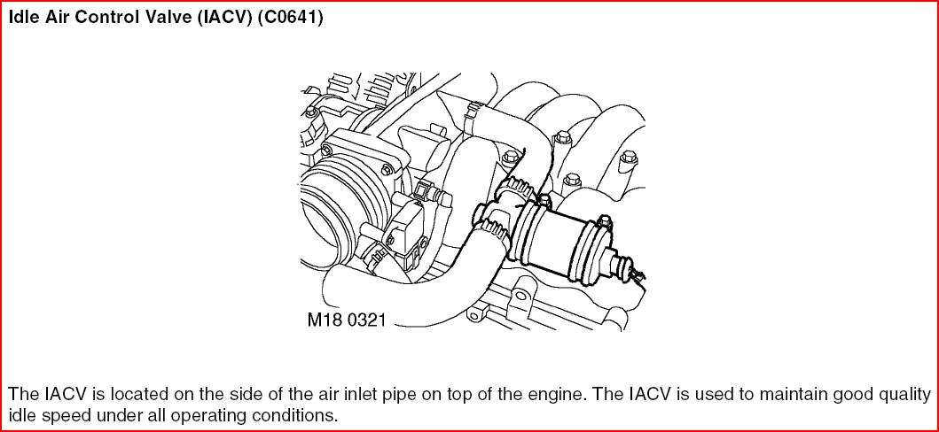

What is an IACV? And where is my idle solinoud located? Sorry I'm not at home with my RAVE to look at

Iacv...
They are the same thing, that tin can looking thing in the pic above
