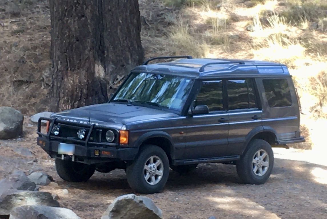

There are no LED or HID bulbs that will throw a correct beam pattern in a halogen reflector. It is difficult to see from inside the vehicle because there is still a "cut off", but there is much more scattered light above the cutoff and it will be blinding to oncoming traffic - especially people with light sensitivity or night time driving issues. Please do not go this route.
If you want to upgrade to LEDs then the only right way is to retrofit projectors into your factory headlights. It has been done - it's a bit involved but the results are very good if well executed. A little more up front cost and effort, but less of a safety risk.
Edit: actually, it's hard to see, but my profile picture has a picture of my disco with projector retrofits from several years ago. Here's a better picture as well.
