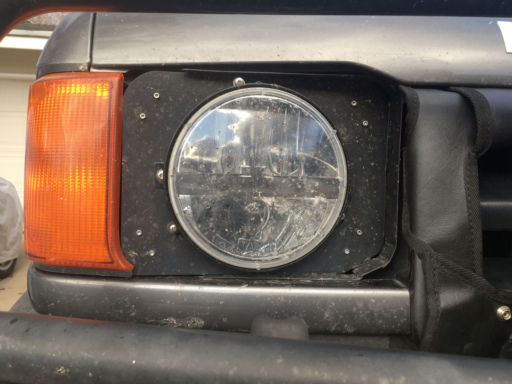

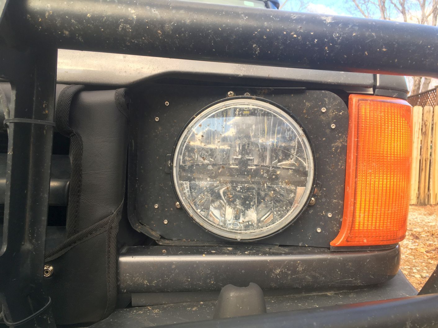

Yes, I had a good experience with Ultraflex 4x4 and the plates came pretty quickly considering the shipping from Australia. If you want them I would just purchase from the ebay store so you have a bit more recourse if something does go wrong:
https://www.ebay.com/itm/15475726523...item2408407753
Here are a few close-up pic...keep in mind that I have version 1.0 of the product which has the "wings" whereas the current version is just a flat plate. I agree that a big benefit of the product are the provided plastic clips but I would also suggest ordering a new set of LAND ROVER DISCOVERY 2 1999-2002 HEADLAMP FIXING KIT STC1232 as those are often brittle/broken as well.
