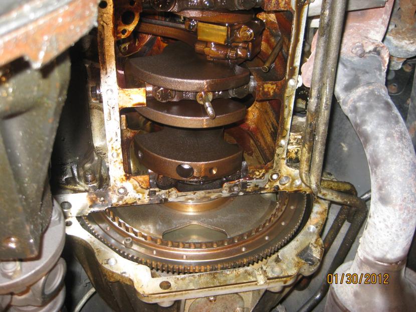

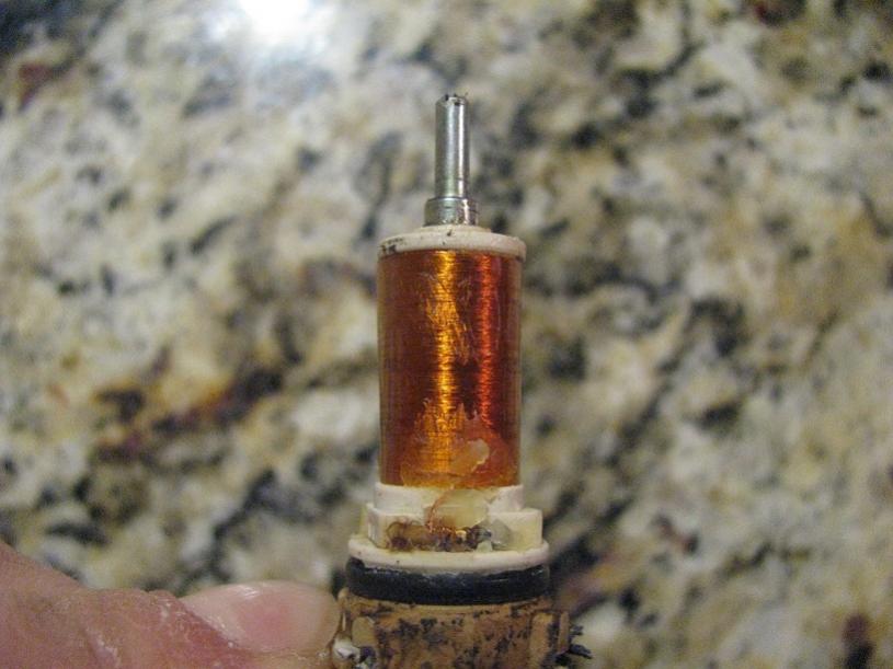

The CKP makes a signal pulse every 6 degrees of rotation (well, there is a space left for sync), so a sensor with metal filings on it would make pulses more erratic, as can one that is bent, etc. It is a coil of wire around a metal rod. So if it were failing, the pulses would be erratic, perhaps not as "crisp", so the ECU would do better with a new clean one. On the D1 with the reluctor tabs on a disk, a bent tab can throw things off as well. Pix of senor (thanks Eric), and a view of the reluctor disk it senses, and some pages on the sensor from Bosch.
