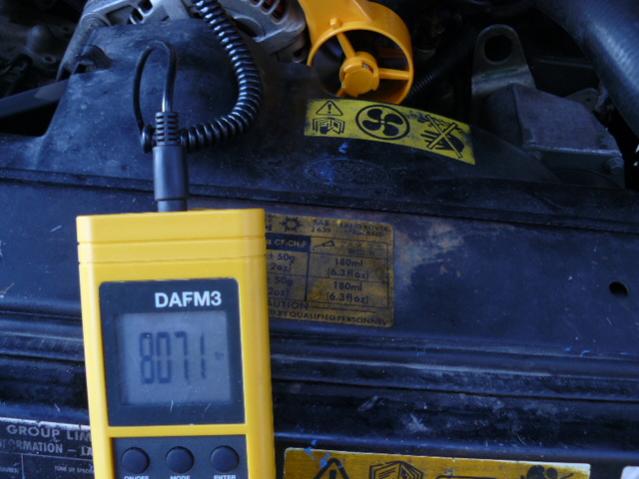

Here it is, a long series, but in there are pix of the GMC clutch and fan that i modified. Clutch is same bolt pattern as Rover, 6 inch, extreme duty, reverse direction. The clutch and fan came from an old GMC (98). Fan blades were a little too big, so I trimmed them carefully with kitchen shears, the blades are "nylon". I made mine a tad too short, I have more clearance around the shroud than I would like. Used an anemometer (air flow meter) to measure the air speed, since size of opening unchanged that means cfm goes up. Air flow compared to stock exceeded stock flow plus AC condenser fan flow. $19 investment from salavge yard for the experiment.

No, was able to mark them from a home rigged jig with some clamps, material is stiff, but cuts without splitting. I figure it is worth 6 - 10 degrees. I was considering this for the old winter/summer thermostat way of doing things. In winter, stock fan and better fuel mpg.

I'm at 12-14 with the larger flow clutch. Pix with stock fan, with larger clutch feet per minute air flow was 1150
