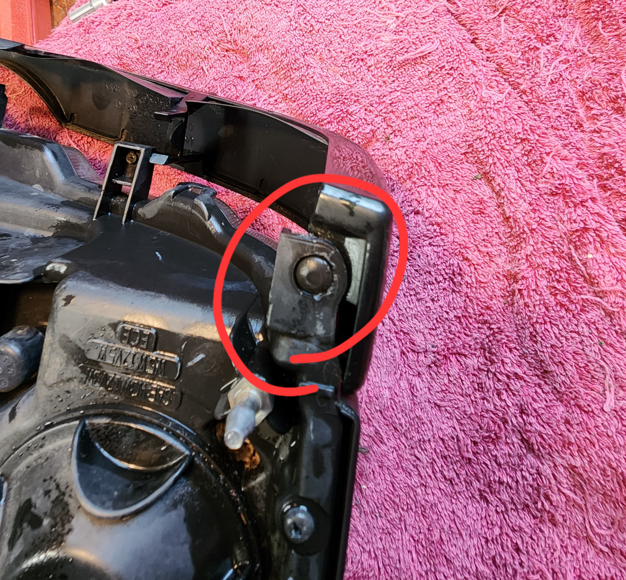

This should be real easy but I'm worried about breaking it, I got the first three tabs out but the hinge of
the corner I don't understand how it comes off.
Thanks in advance.

I think there may be a hidden screw you're missing.

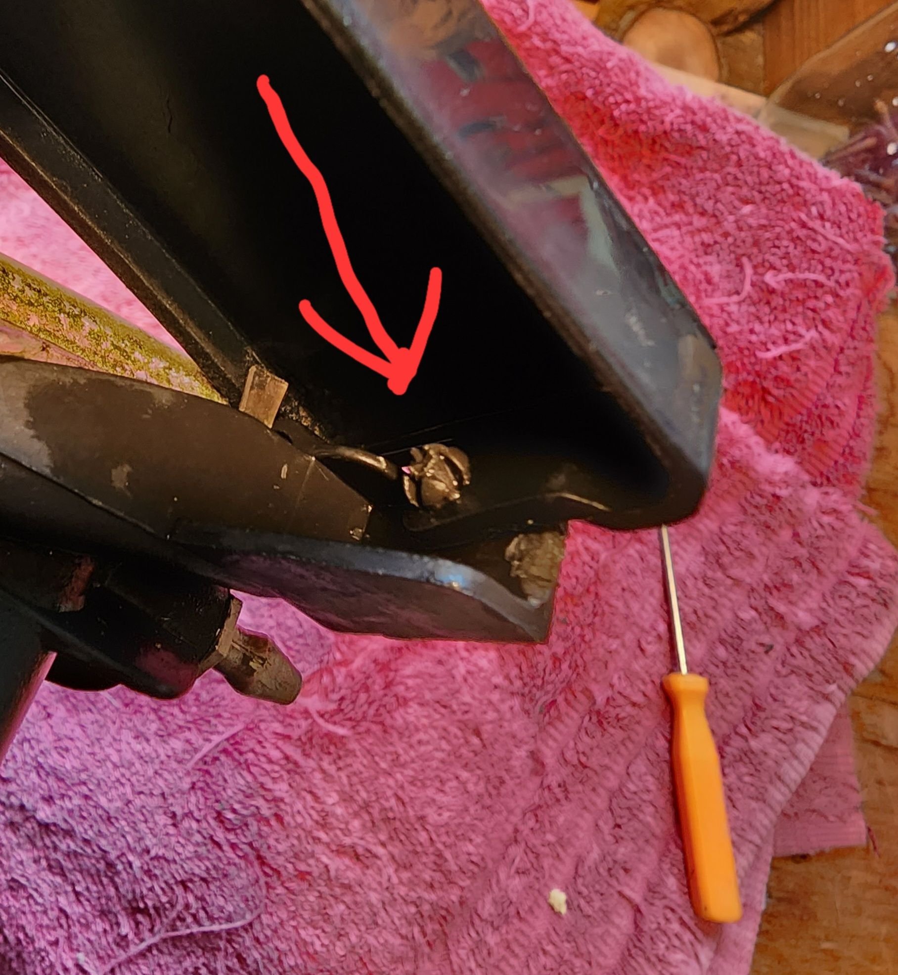

Default Gently pulling and prying but i dont want to break the plastic
Cant find a screw, only this plug shaped thingy. The back side is round.

Yes! Sorry, that’s a push pin thingy. You need to drive the center out with that tool you have. Drive it from the smooth side to the mushroom side, and DON’T lose the pin. You need it to reattach the thing. Once out you can extract the mushroom thing. It will make sense when you get the pin out.

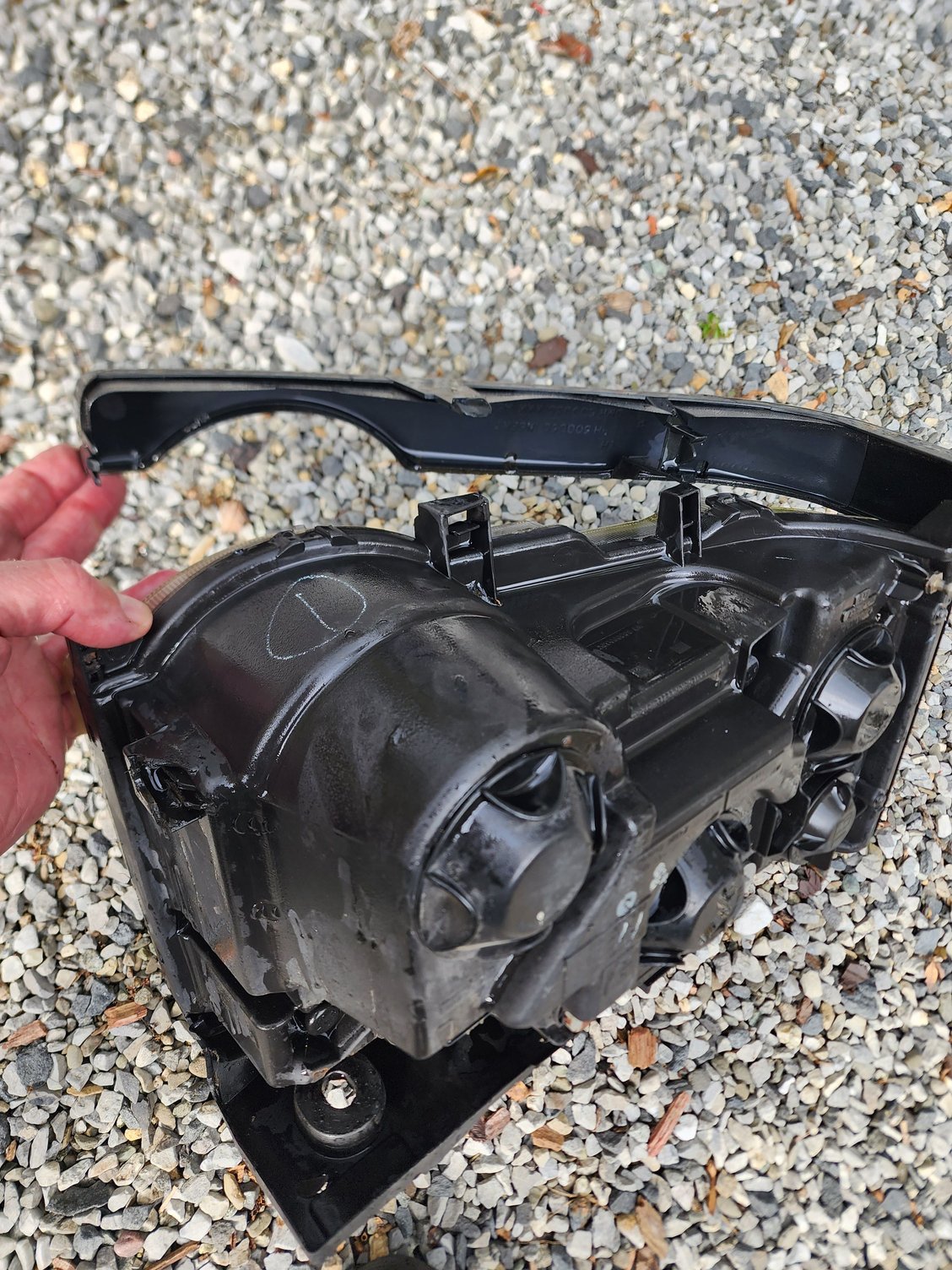

Default I couldn't get it. But thanks
I wanted to remove to clean and paint, wound up throwing and taping a bag over the headlamps, came out perfect.
