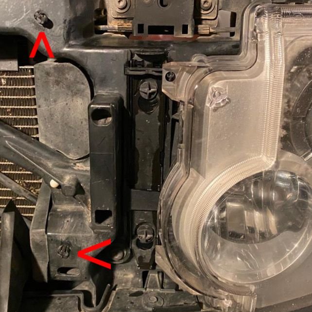

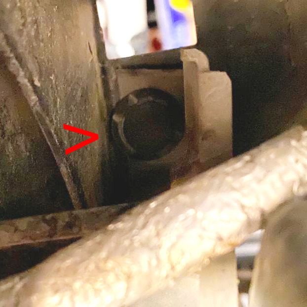

Hi! New to the forum and couldn’t find the answer via my searches so I wonder if anyone can help. I’m trying to remove these clips which sit behind the front grille of my LR3. I took a picture from the inside (top pic) and they look like those wheel arch clips. I would know how to remove them if the caps are on the outside, but they are not. There is no room for me to reach to the caps from the inside. Any light you can shed is appreciated.
From the inside
From the outside

They are the same as the liner clips, you can see the little gap where you can get a small screw driver under to pop it out.

Thanks for helping out. The cap where the screw driver under to pop it out is inside with very limited access (top clip) & no access (bottom clip). Anyway, I will take another look at it. Thanks again!!

Get old screwdriver or piece of steel rod with end beaten flat and bend it to an L shape so you can pull that clip up.
