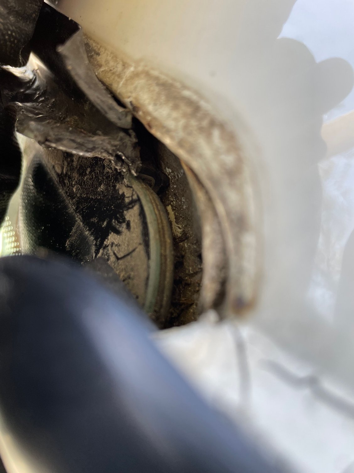

Got some rust on the roof that reaches under the upper lip of the top windscreen finisher. I'd like to pull the finisher out, mitigate the rust & put a new one in (got the replacement in hand already).
It looks easy enough in the RAVE but this thing isn't budging -- anyone have a tip / trick to get this out? Do I need to remove the windshield to get this piece out?

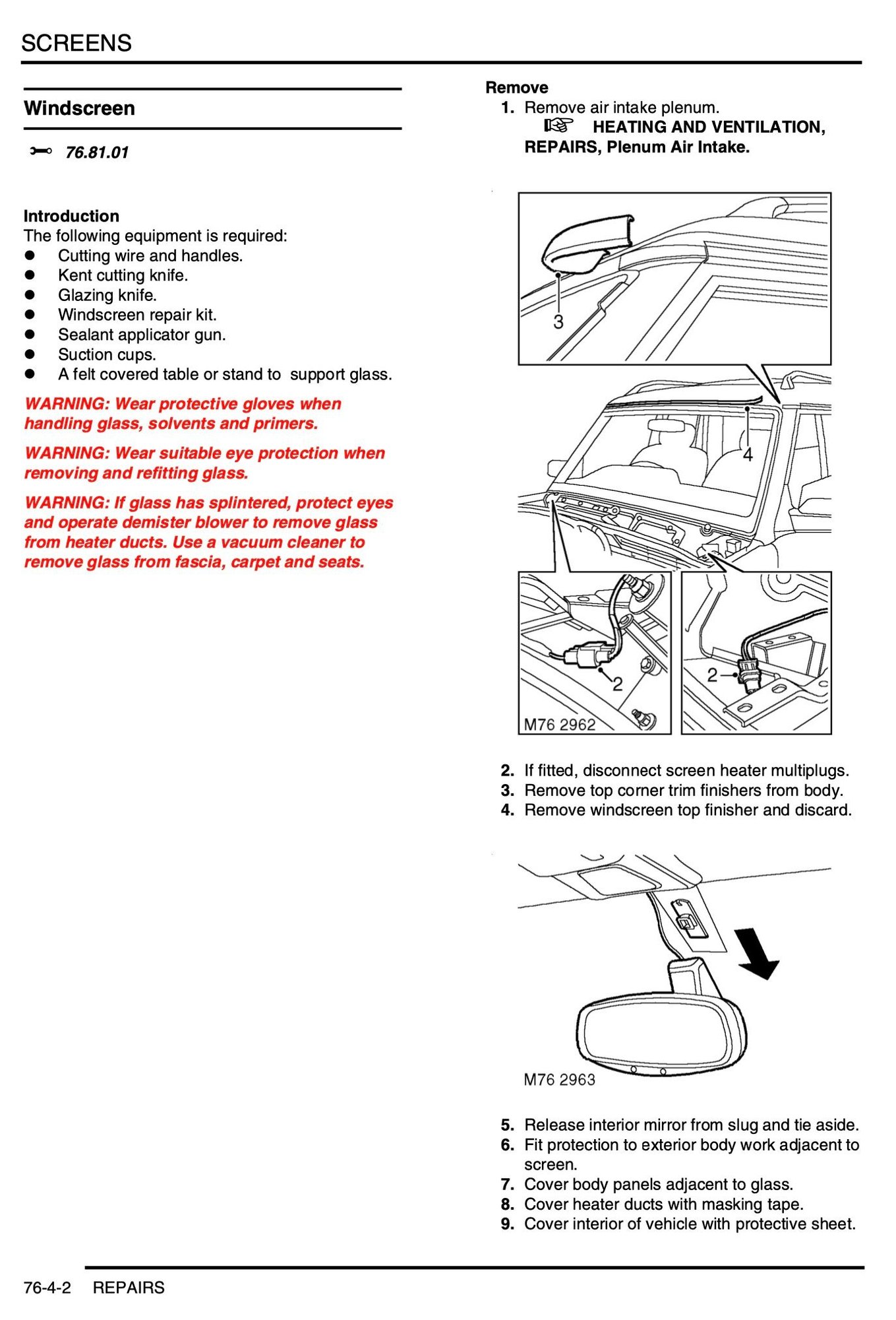

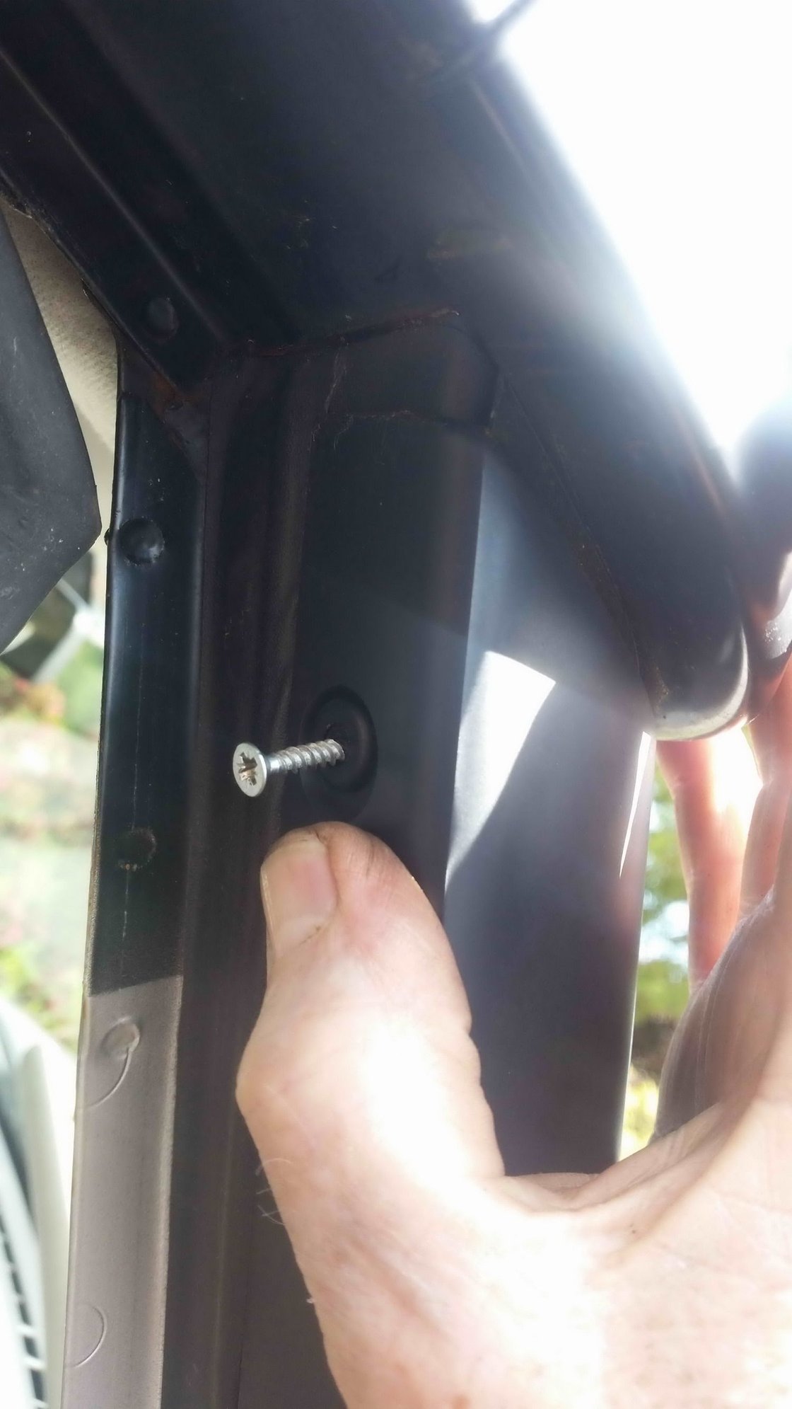

best thing to do is to get the screen removed do the repairs you need to do then replace the screen, I have removed all the plastic round my screen to carry out repairs, and re seal the cutter to stop water getting in you cant remove the top bit of plastic unless you remove the outer 'A' post cover, I did it by drilling a very small hole in the small round plug then screwing in a self tapping scre and then pulling out the plug this then lets you remove the clip that locks the cover in place

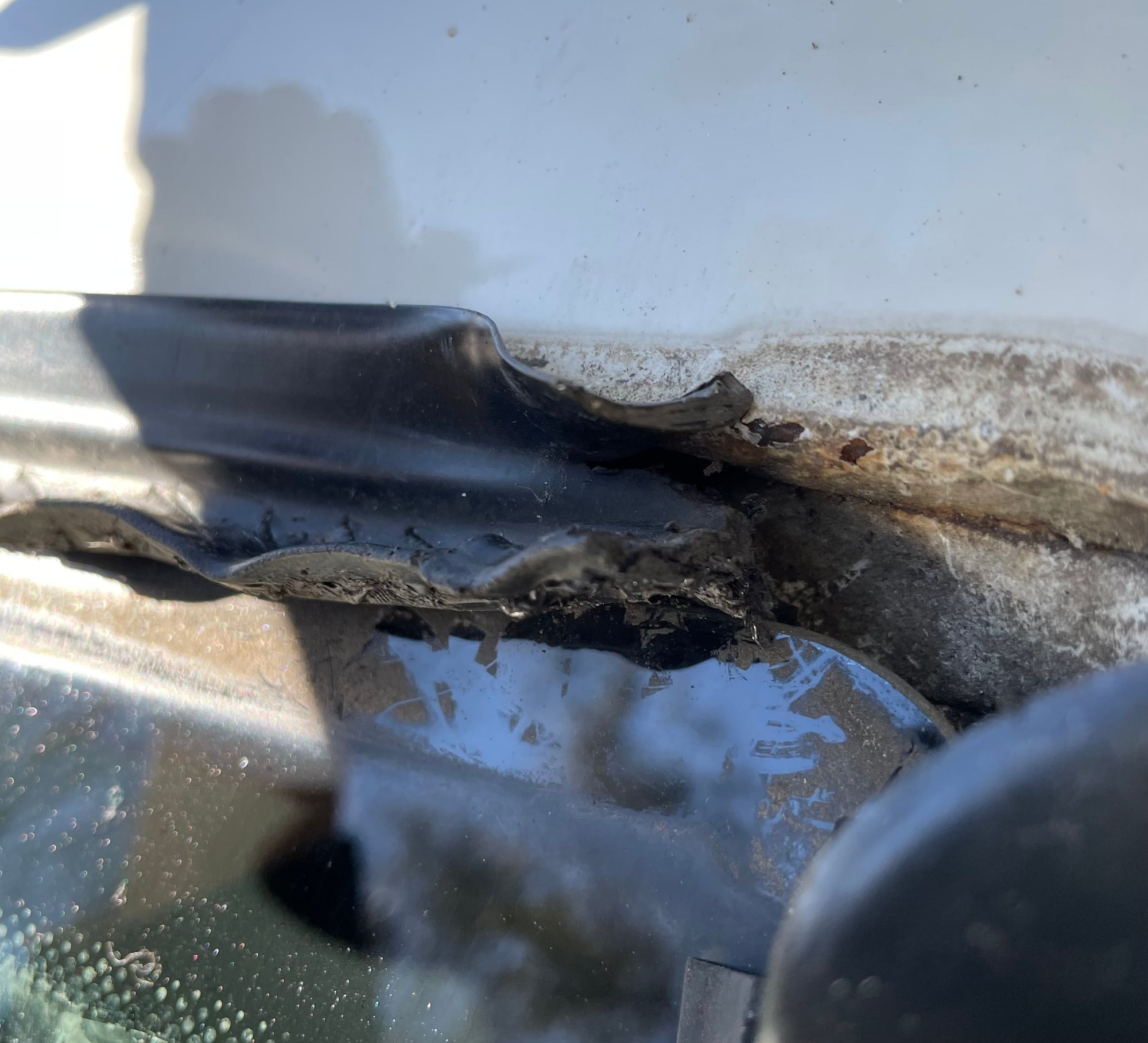

Thanks everyone, will give this a shot.
Here's what I'm working with so far, using plastic trim tools & pliers to try to pull it out (have unintentionally ripped off the bit on the corner as you can see):
