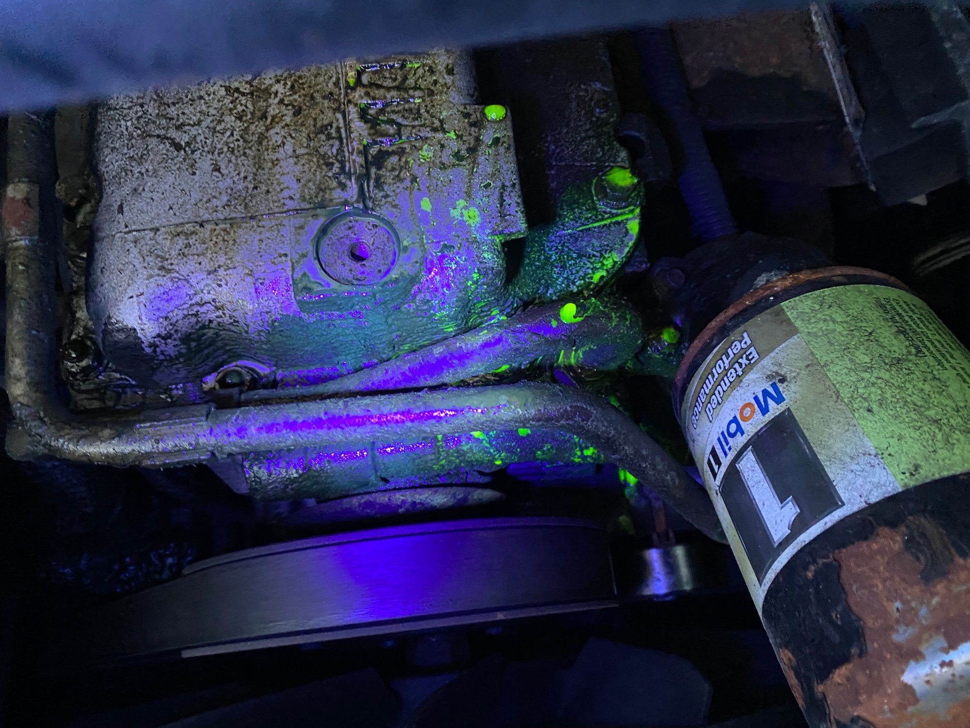

I’ve noticed a pretty significant coolant leak with the D2 when parked after driving a short distance. I got some coolant dye and it looks like it’s coming from the water pump but was hoping for confirmation.
See the attached pic - is that water pump? Something else? If replacing water pump, what else should I do?

You have too much crap on there get some engine degreaser and get rid of that, it will really help.
But I would suspect the hose above the oil filter.

Could be hose or pump. Try looking at the weep-hole on the pump, you can see it from the top side.
Yes, cleaning up area would help immensely.
