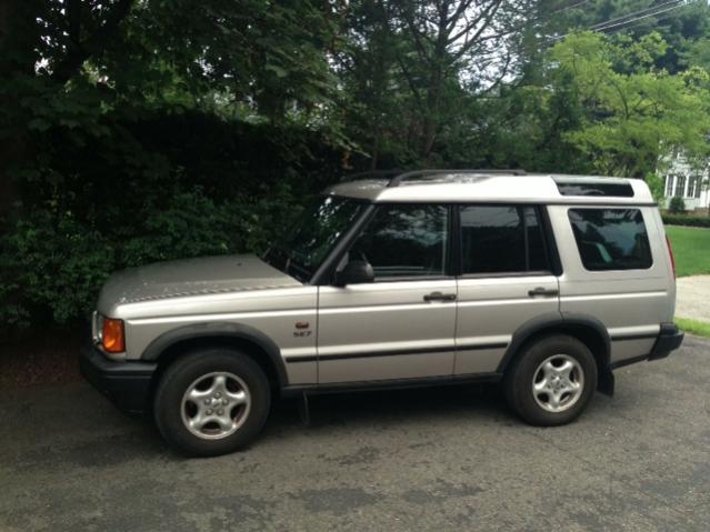

Also attached some pics so that I don't get a "this thread is useless without pics" comment
Attached Thumbnails Help a new owner prioritize maintenance-photo3.jpg   Help a new owner prioritize maintenance-photo2.jpg   Help a new owner prioritize maintenance-photo1.jpg
