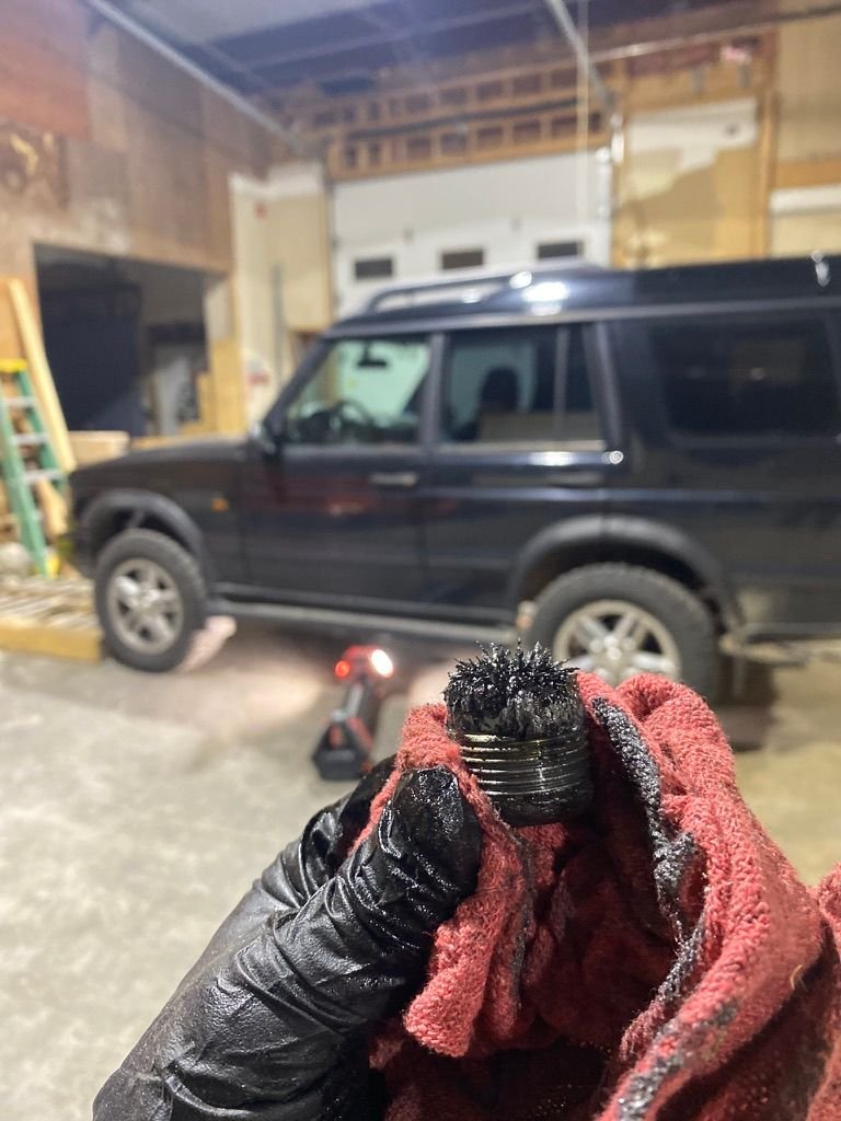

Symptom: "clicking" or "clacking" at engine speed from the rear of the vehicle most notable after removing foot from accelerator and/or coasting. Metal shavings in rear diff gear oil as picture below.

-Changed gear oil in T case and both diffs immediately upon taking ownership of the Disco and again about 6,000 miles later, after the roto-flex delete. The photo from above was taken during the second fluid change, so after the flange swap.

I’m not the diff expert, but that’s a lot of metal on your plug. I’m pretty sure the Rotoflex drive shaft was not the cause. It’s supposed to be okay up to a 3” list. At any rate, I think it would only cause the driveshaft to wear sooner, but I don’t think it would harm the diff itself.

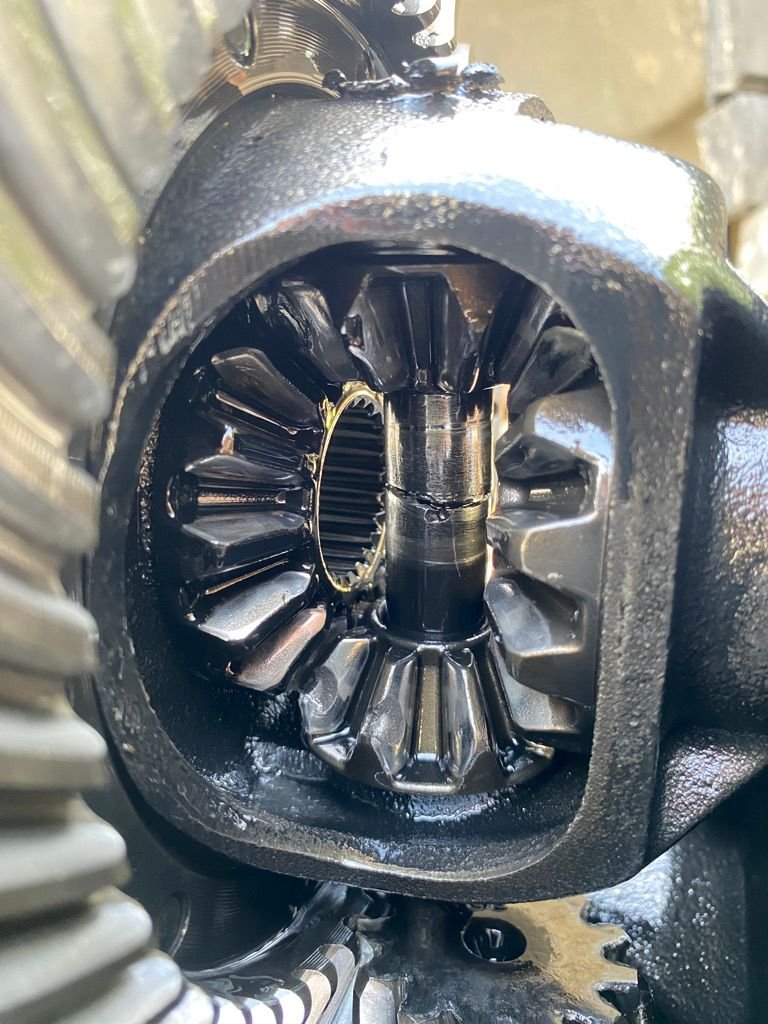

I finally have an update on this issue. Life outside the Disco along with sourcing parts delayed things a bit longer than I'd hoped but I followed your advise. I sourced a used diff off ebay for about $130 with shipping (along with a whole new rear brake setup while I have the axle in pieces).

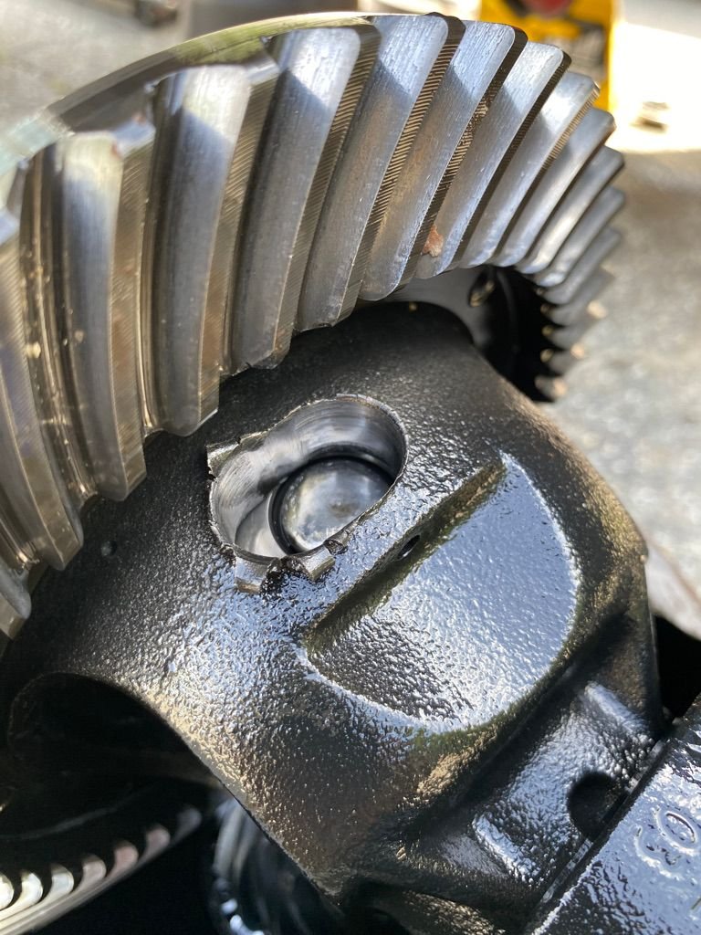

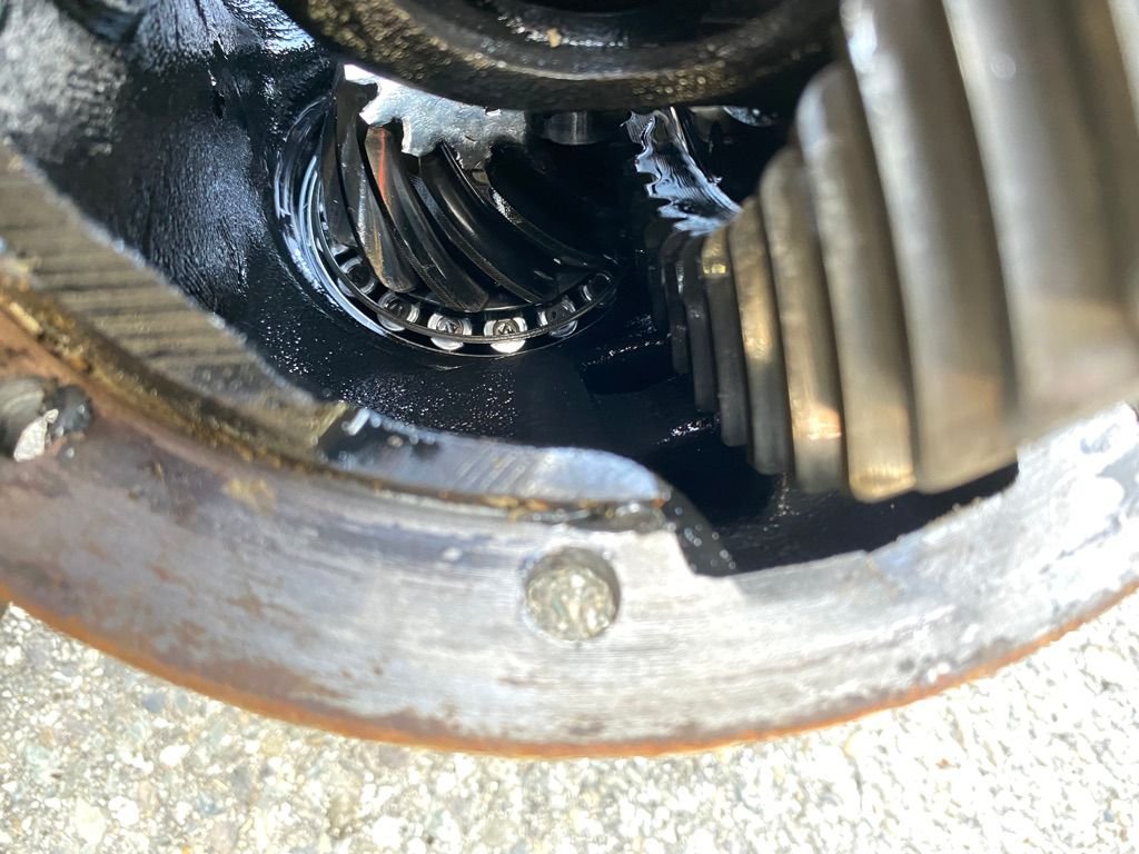

Turns out the bearings look fine. The cross shaft in the spider gear group sheered in half. I'm not sure if one of the roll pins securing failed first or what but this is what we're dealing with:
As you might can see from my photos, there's damage to the inner radius of the crown wheel splines as well as the so called "planet" and "sun" gears. Obviously the carrier is toast too. Given this, I'm assuming a total loss of the differential unit here. Please correct me if I'm wrong but based on a cursory pricing of the individual gears I'd quickly get very near the price of a new replacement unit. Kind of a bummer as I was looking forward to learning the overhaul. No tears though. I have other means of having fun.

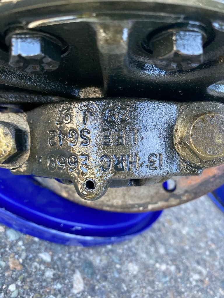

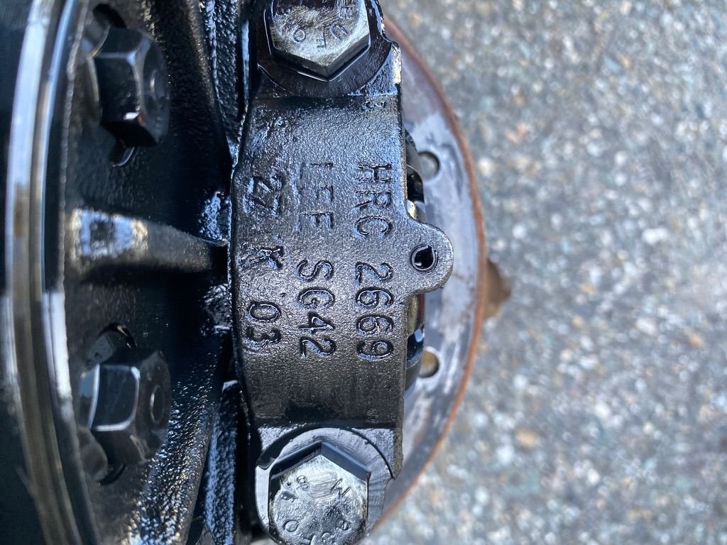

One thing of note is the difference between the damaged differential and the used replacement sourced off ebay. Mine is 2004 D2 and the markings on the bearing caps indicate (I'm assuming here) a manufacture year of 2003:

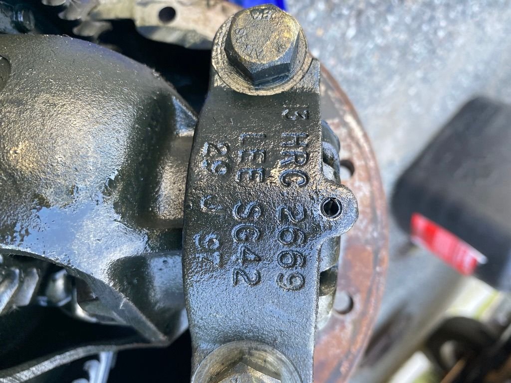

The replacement reads thus, and therefore I assume it's from a '98 model produced in 1997:
I'm kicking myself for not taking a couple photos of the gearing in the '97 example but time was a factor and I just needed to get it installed. I noticed the cross shaft is significantly smaller in diameter than the '04, about a third smaller I'd wager, and is retained via two c-clips rather than roll pins. Given the larger cross shaft sheered clean in half (granted it took about 19 years to happen), I'm curious to see how long this even older example lasts. Do either of you have any knowledge or preference in this design change for the '04 models?
One final question: All of my research leading up to this indicated there's no difference between the front and rear diffs apart from the 3-hole vs 4-hole flange. I'd already performed the roto-flex delete so when sourcing a replacement diff I settled on one with a square four bolt flange thinking it's plug and play with my Tom Woods driveshaft. Now, after the swap has been completed, I notice in the rave it mentions on page 51-10:"NOTE: Older front differentials have a square flange and an extra spacer fitted, this spacer must be removed. Later front differentials have a round flange but no spacer fitted."
I'm wondering if that's what I got. The RAVE isn't specific of model years qualifying as "older." Perhaps there are some clues in the markings photoed above? If need be I could always pull the flange off my broken diff and swap that but I'd really prefer not.
Hopefully I'm shored up for a bit. My backup vehicle is now on the mend so I'm needing to get the D2 rolling again. Any advise or assurances is, as always, greatly appreciated.
