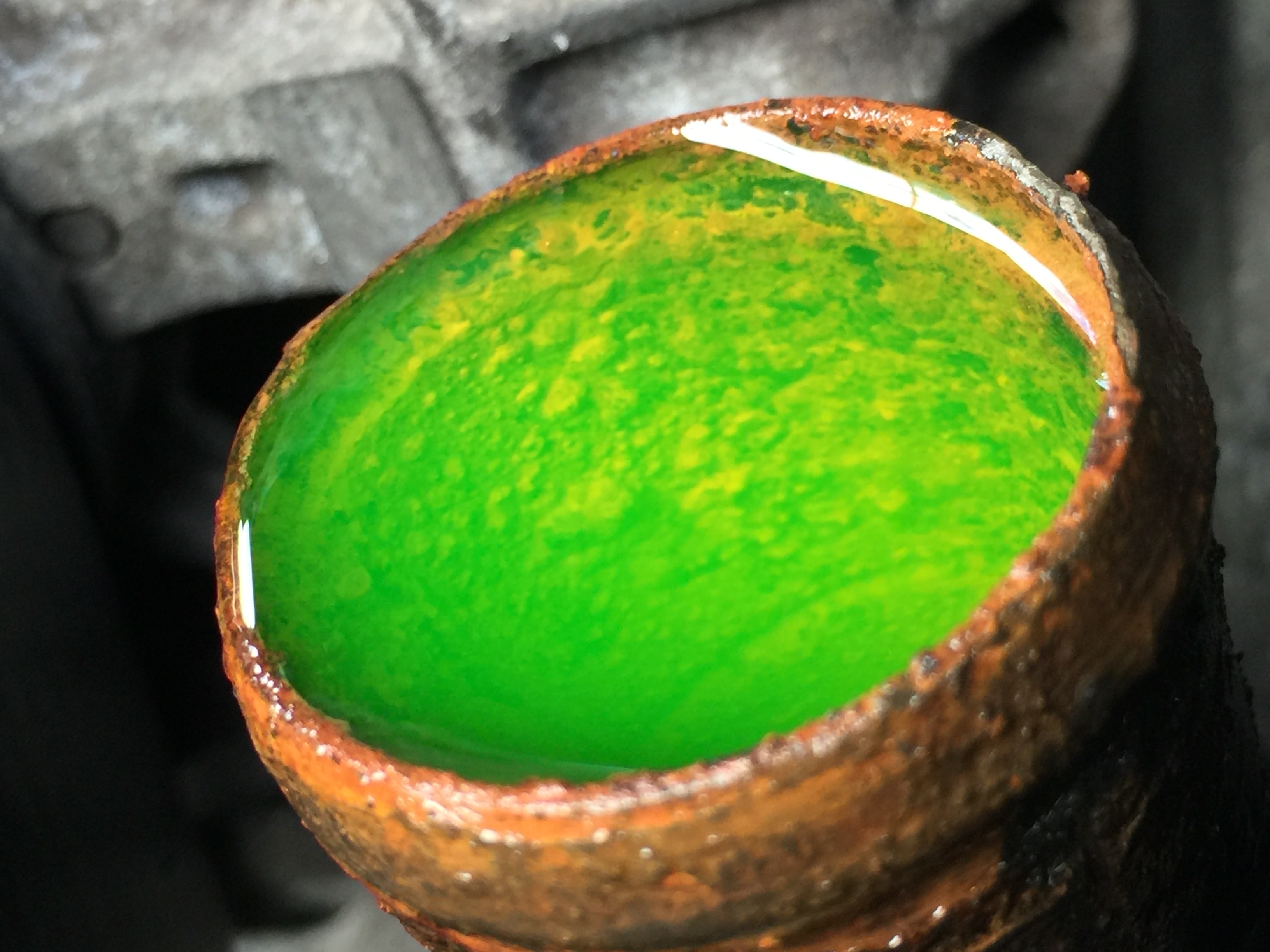

this guy doesn't want to leave...
so, it's time for surgery !

wow....

new hose in place, now time for the "notorious" brass screw

You keep using that bleed screw - then you deserve the results you earn,
Sorry but,,
There is a reason a Discovery I does not need / use one.
Brass screw is not known for breaking as the plastic one.
There are known notorious bleed procedure that may or not work.

I think that refers to some folk's views that the D1 cooling system or in-line thermostat mod is far superior to D2 system.
When changing hoses or thermostat you'll have more room to work by simply removing fan/clutch, the lower shroud and belt. The less than five minutes of off/on saves time and aggravation.

The "notorious brass bleeder" is working just fine, but I'm still getting " A LOT " of air when opening the bleeder in the mornings.
At this point I'm even wonder if is worth the pursuit.
My wife noticed that there is some coolant spotting right underneath the truck, like right in the middle and towards the rear of the engine bay.
I can't see anything, what could be a common area to look for ?
Is this a common symptom for something?
