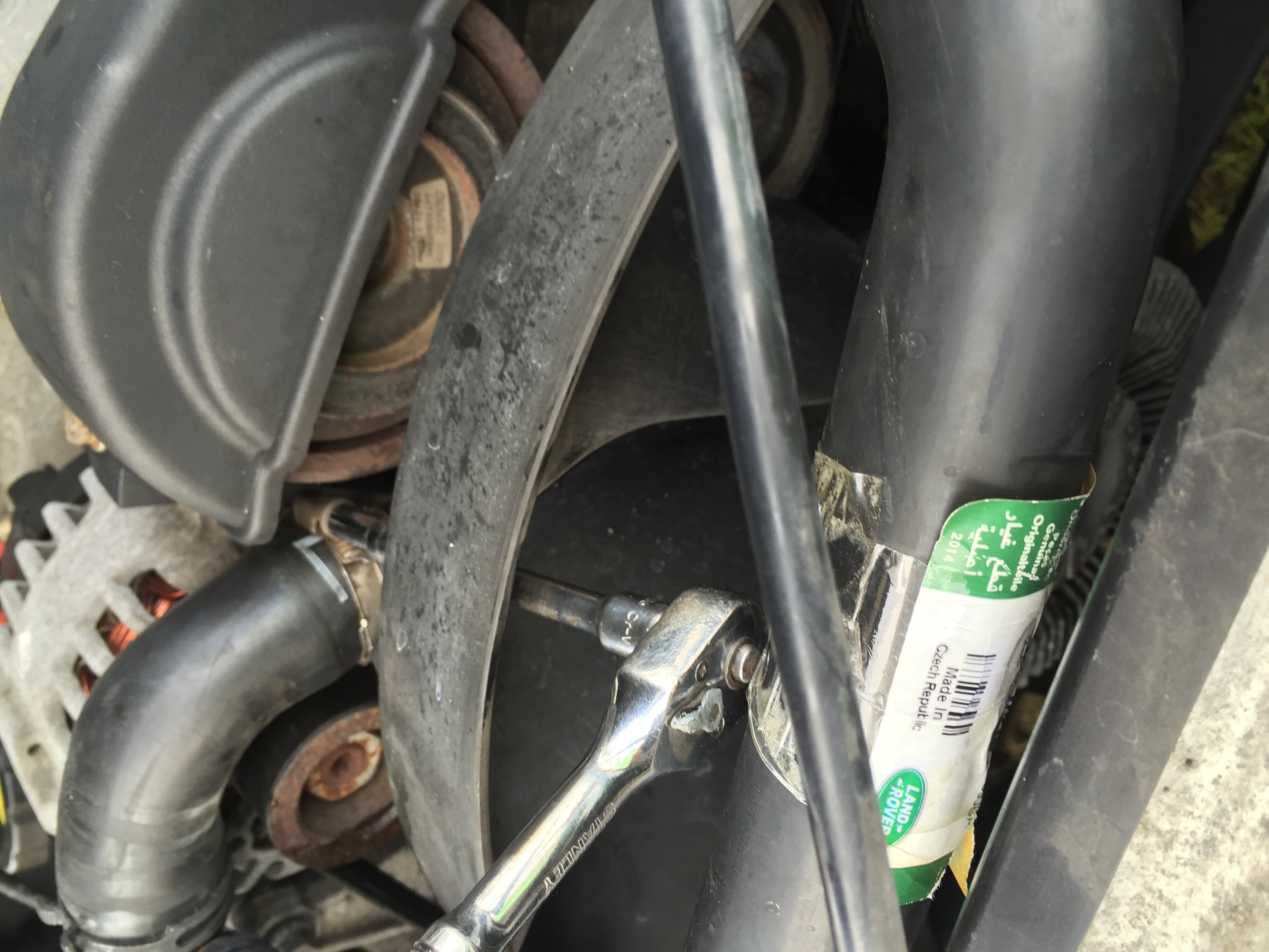

got the brass screw in the mail, but didn't have the chance to work on it yet.
also have the "right hose" to replace and working on it.
Please excuse the multiple post for the pictures, but while working I'm taking the pictures with the phone and for some unknown reason I can only upload 1 pic at the time.

going for the hose first.

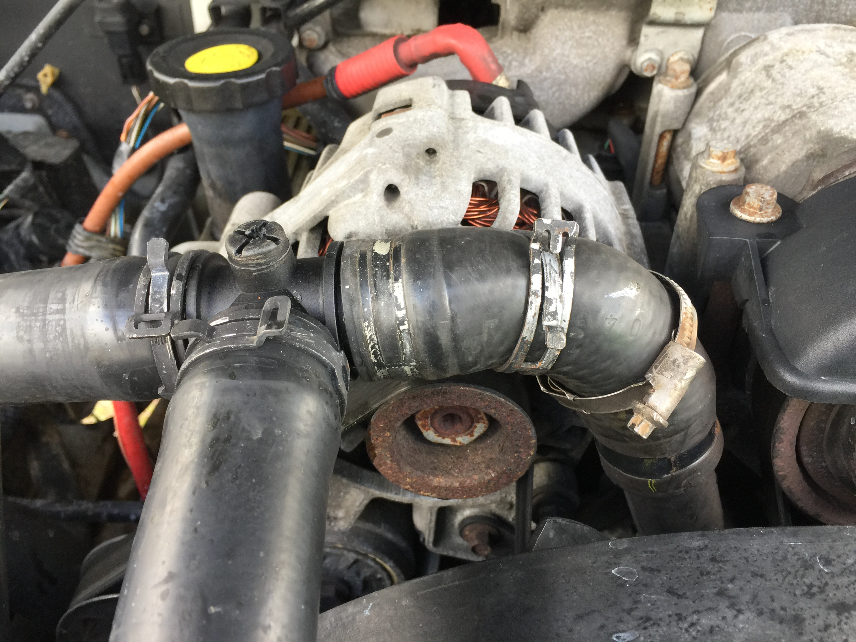

little trickier...
