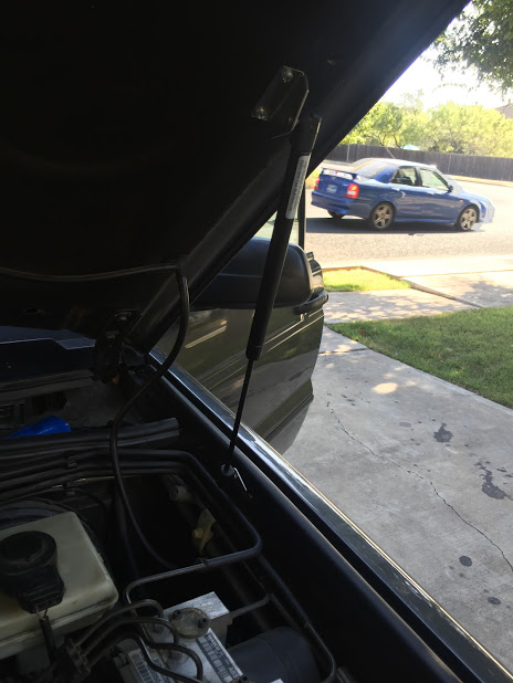

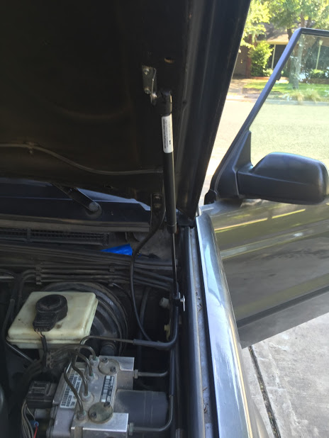

Originally Posted by Joemamma1954
Installed mine on drivers side and doesn't touch anything. Now I am going to order 1 for passenger side. just for grins.
Attachment 26864
Attachment 26865
Had to add "Alex_M prop mod" to signature
Wondering if it will be hard to close the hood with two 60 pounders. Not sure how the math works on these, but, seems like two struts would provide 120 pounds of lifting force,....so,....if the hood weighs 60ish,...then you would have to pull down with 60 pounds of force?
