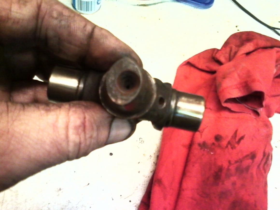

I just rebuilt my shafts as preventative maintenance because they had never been done. I wasnt having any symptoms/vibrations at all. Truck would drive 100 MPH smooth as butter. I had one u-joint in the doubl cardon that was completly dry with rust in it. Get it done!

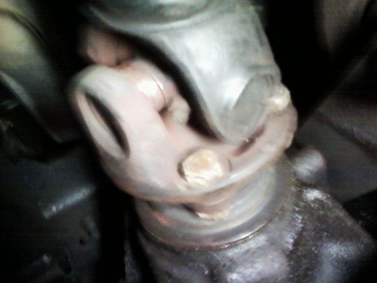

sometimes the make noise sometimes not.
What looks good on the outside does not meen its good on the inside.
Attached Thumbnails How can you tell if the drive shafts are bad?-0301131543.jpg   How can you tell if the drive shafts are bad?-0302131408b.jpg

Like I said earlier. Mine had no vibration at all while driving (100mph) and I shake/push/pull on my shafts with all my might with every oil change and have never had any slack/slop. That bad joint in my double cardon was bone dry, rusted and scarred up. Very happy that I decided to do it as preventative maintanece.
