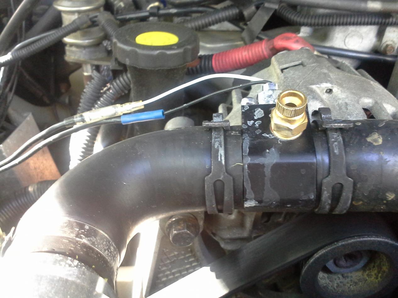

Couldn't you just wire a resistor in line with the temp sensor to fool the computer?
it's variable depending on temperature. You might be able to do it with a resistor? but I don't know.
This idea is along the line of what I want to do. Just don't know how to. Just trying to see if I can get normal results out of a colder engine with the SES light off without a whole lot of work.
I would sure try this. It's cheap and easy. Start with a low resistance and move up till you get the result you want. They cost pennies each.

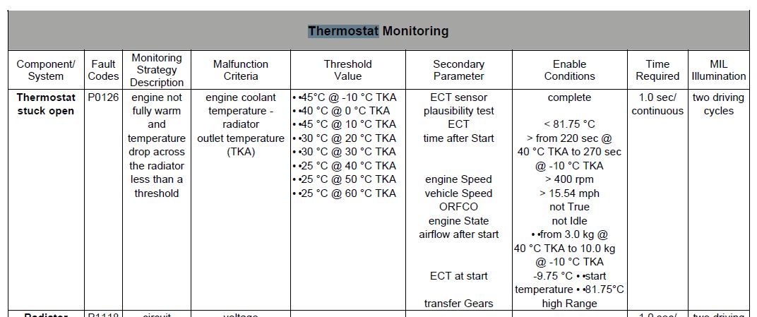

Jesus. The code is because the engine is too cold, order a 170. And if that's too cold go for 180

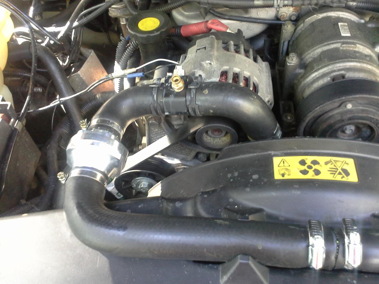

Just got back from my trip to the mountains of TN. Got just under 17 mpg. Had 4 people in the car, luggage, a/c on, and SES light on for engine being "too cold".

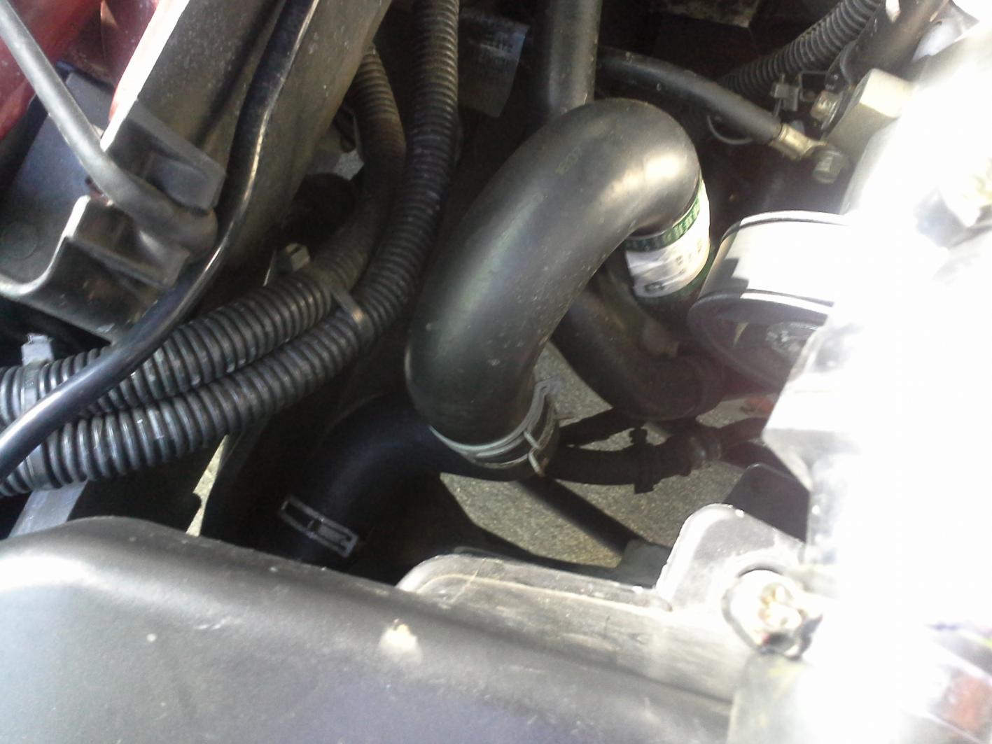

As for the thermostat SuperSport, I got the guidance from this site and the in-line thermostat mod thread. Did it a little different since I had just bought new hoses, thermostat and water pump just before I did this mod. Super easy. I originally didn't drill the thermostat. Bad idea. Takes too long for thermostat to get up to temperature. I then drilled 2 holes. Probably will go back with one. Seems like it could warm up a bit quicker.
