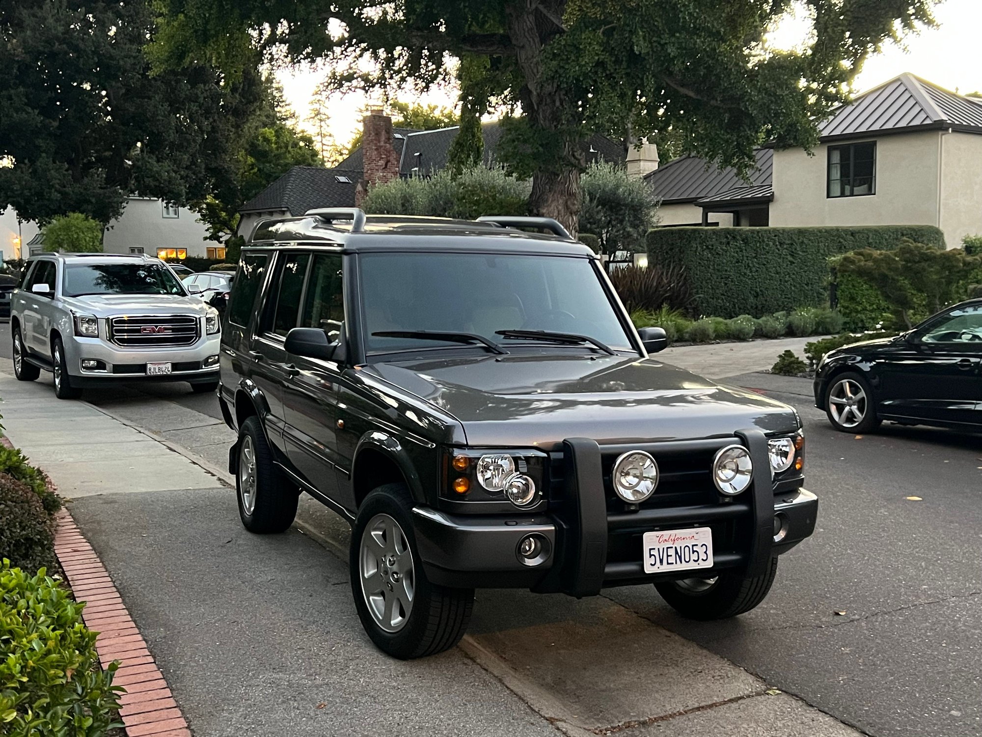

I pulled them off slowly using a plastic pry tool and knocked off the residue with the 3M eraser wheel. came out great and I don’t have to look at faded sun baked plastic arches.
