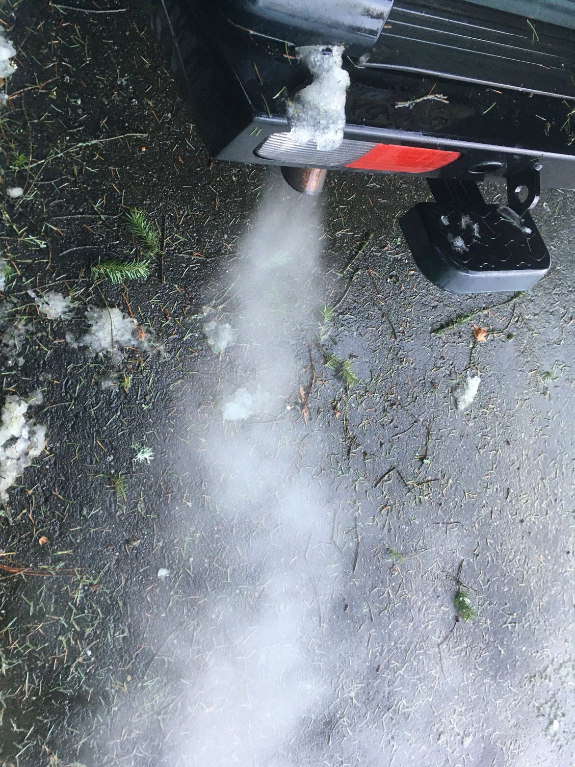

If the hose that was off is the crankcase breather it could cause an oil light flicker. The problem is you have a bunch of small issues and the mechanic you are using seems pretty kind a of clueless.
This is condensation, it lasted about 15 minutes or so
You can see the snow on the bumper, my Disco had been sitting for about 4 days at this point.
Mine blows like this constantly. Yeah the mechanic is kind of just repairing some small issues but I guess the more important things I've gotta take to a specialist/do myself. Not sure why that hose was disconnected though, it was odd. I am running about 198-206 when driving but unfortunately when I hit about 208 degrees thats when the electrical **** (like a speaker crackle) and the oil light flickers sometimes the car stalls... what could this mean? It's just a weird issue. If I turn the car off and try to restart it, I have to press the gas at first to get it to crank.
