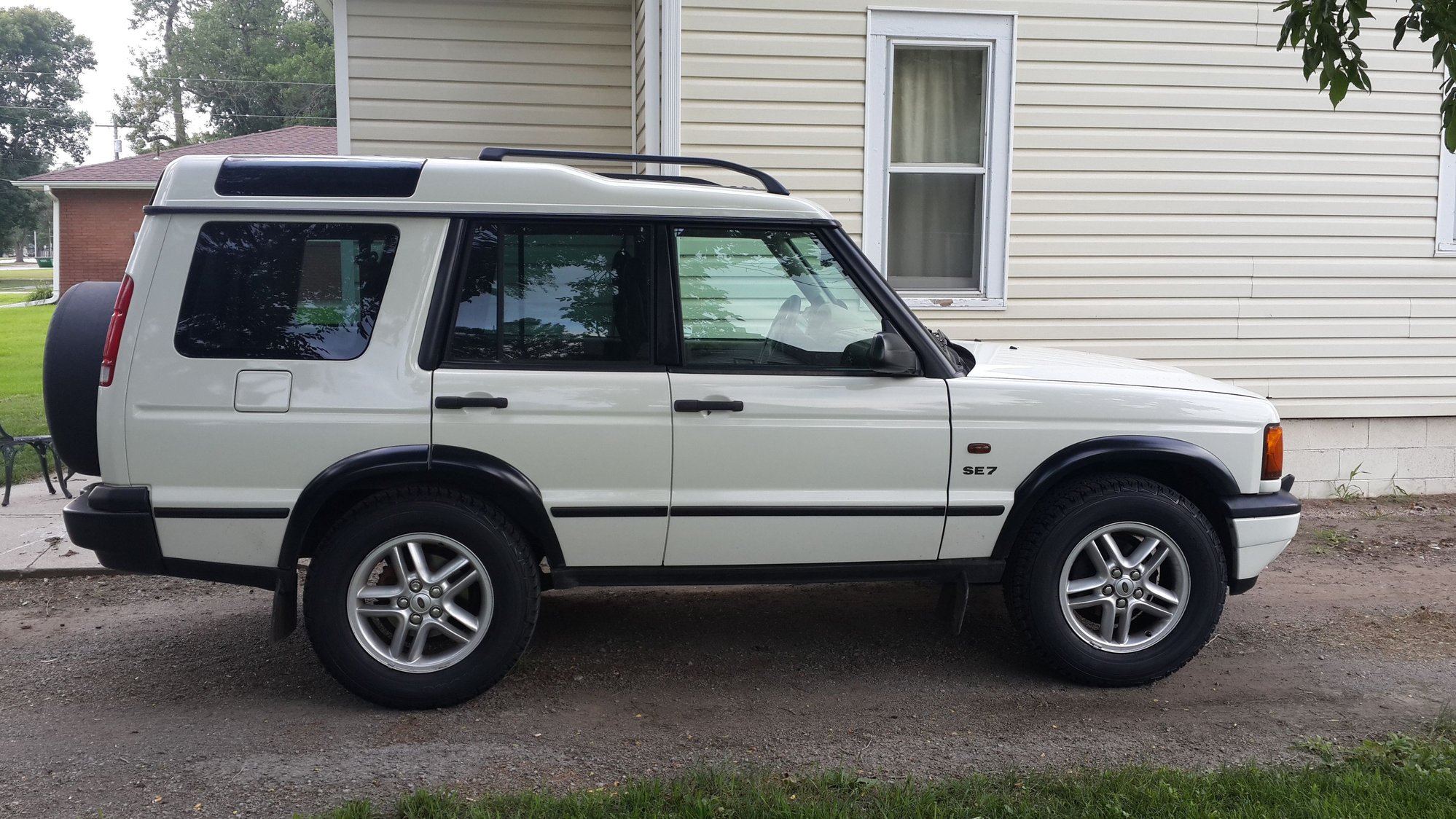

I was looking at the KO2s but wow are they expensive. At the recommendation of my local place I went with 265/65 Hercules TerraTrac AT2s on my 18" rims. They are very low noise on the highway and handle sand and rocks pretty well. In mud they will clog fairly quickly but will also clean rapidly after you get out.
I do get a little bit of rub when I'm close to lock but only when turning in one direction, so I think it's mostly because my wheel arches are kind of dinged up and out of shape. I also had to flip the mount for the spare to get the back door to close.
