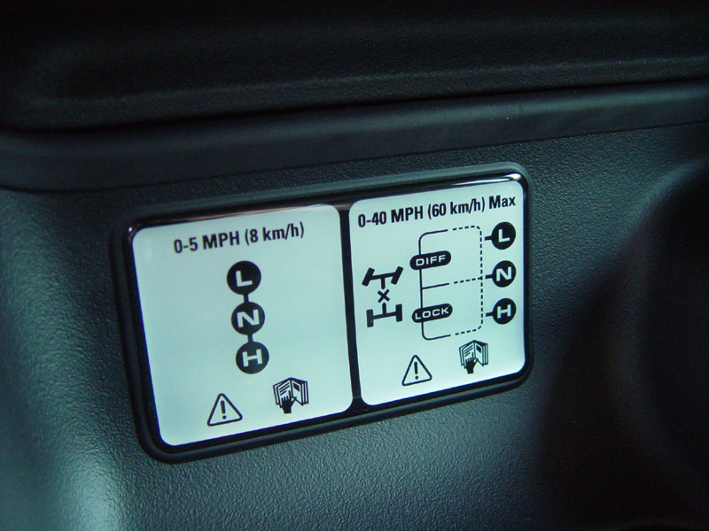

Hello all,
I am ashamed of myself to ask this question, but I can't for the life of me figure out this diagram. lol.
So, I put it in drive (automatic) and move slowly forward, then I stick it in Neutral (automatic), then I manually thrust the Lo Gear Stick Shift forward, put the automatic shifter into D (or 3,2,1). But are the lockers on? Can the stick move to the left? What's with the dotted vs solid lines?
Jean

There is only one locker, it's the center diff lock.
Move the lever to the left, unless it's frozen.

Hi Jean,
If not mistaken you have a 2003, which does not have a locking transfer case. 99'-6/2001 came with a locking transfer case but no shifter to actuate it(many people buy D1 shifter and attach). After 6/2001 through 2003 did not have a locking transfer case. 2004 came with the locking case and a cable actuated shifter which was a 1 year only item.
Unless your Canadian version is different, you will need to source a locking t case and shifter to install.

It's definitely got the correct sticker for the CDL...
Yes but... It was a widely known error for the 2003 to have the incorrect sticker. I think there was even a TSB about it.
I've had 2 2003's that had the sticker but no CDL

Does the shifter **** have the same pattern on it as the label?

Shifter **** inscription only says H - N - L

Sorry no cdl then

Yeah, I forgot to mention. The **** is the telltale giveaway.
