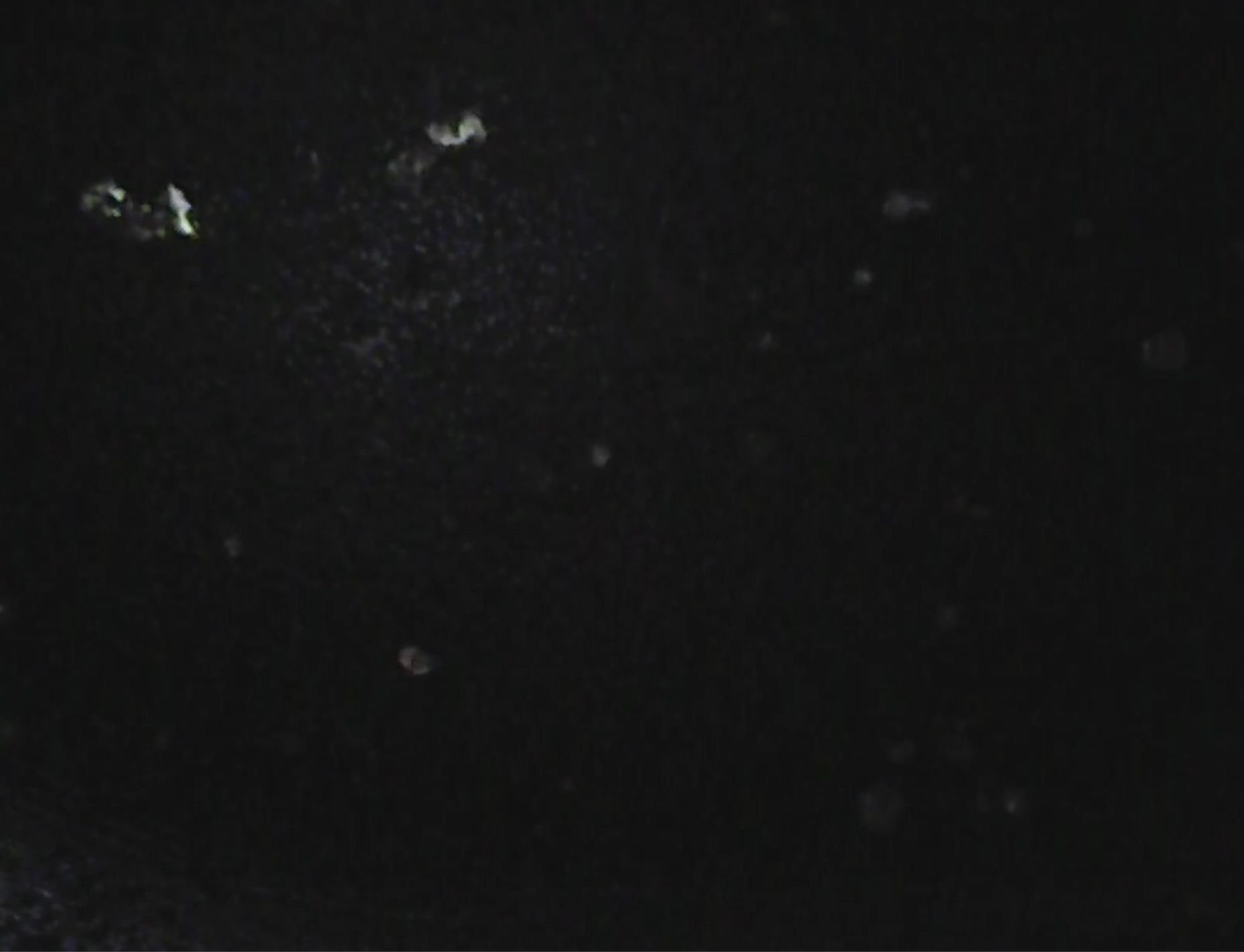

Soooo…… cylinder #5 has 0 compression and I have little metal chunks on top of the piston. My assumption is I have a broken valve/seat. The pic is from my endoscope. I am hoping the worst is having to replace the head. The boy is excited to dig into this. Luckily, we both see this as an adventure.

Did your boroscope come with a little mirror attachment? If yes, then you should be able to sort of look up and check the valves.

I wish it did. It would be nice to know but won’t matter. The head is definitely coming off at this point.
