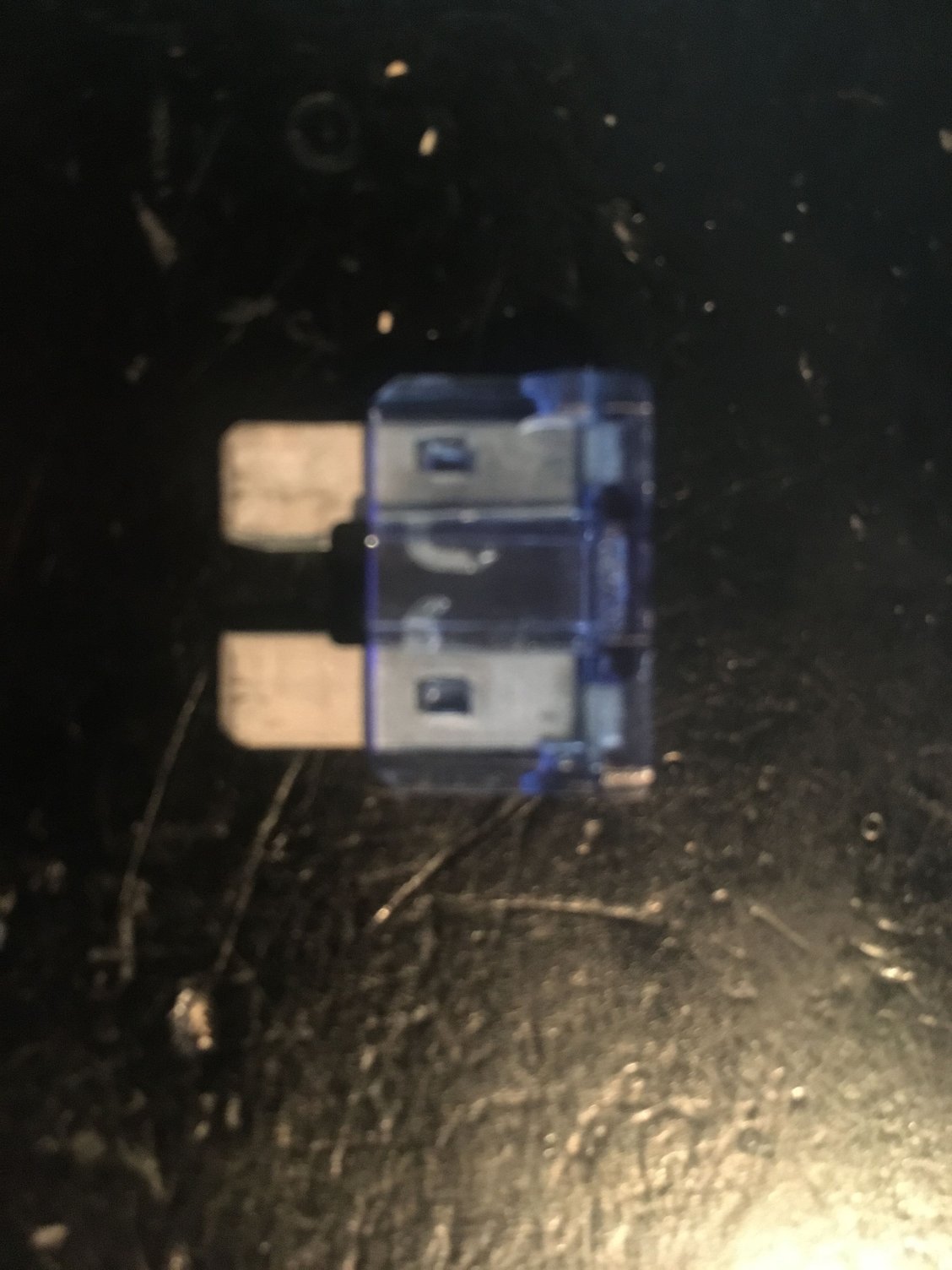

By fuse 2, do you mean the fuselink (the high amperage ones) or just fuse 2?

Yes, standard fuse #2 (15 amp I seem to recall), not the fuse link. That alone fixed a ton of my issues, but I still have a wiring short to trace down somewhere. I'm guessing you might as well.

It was fuse 2 that was blown. So not the ECM. Whew.
All codes gone except for the P0102 MAF (known problem, new Bosch MAF sensor on the way) and a P1884 (not sure what that is, but better one new code than 18).
