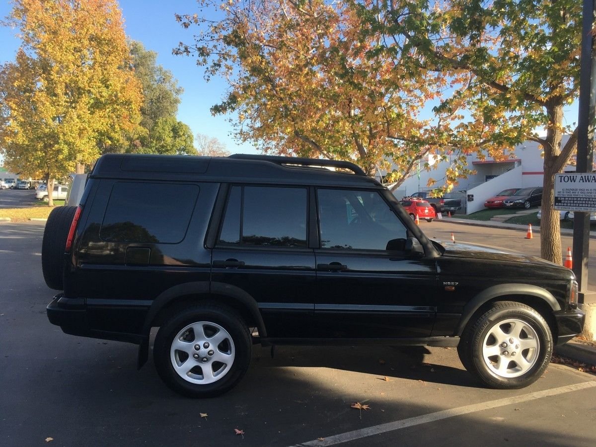

Hey all!
I'm new on the forum and an even newer disco owner. I've just moved in to the US, so this was my first time buying/owning a car and dealing with repair shops here, in NY.
I have been enjoying reading the tons of advice and tips for my newly acquired Disco 2 HSE7 2004. It has 92k and looks quite the part for an old lady. Quite a bit of cosmetic work here and there, but nothing "major" said the dealer that I bough it from, 4 weeks ago, in San Diego.
Just got the disco checked by a reputable and honest shop in NY (recommended in various threads here) to get a more thorough check up, as I felt the suspension was a bit boaty / floaty and there was this kind of weird sound coming from the engine.
This is the quote that I have just received from the shop. They are really nice, and actually will let me buy my own parts for them to install. The grand total is fairly steep.
Full disclosure: I am not mechanically savvy, I can generally build stuff and fix things, change fluids, but real work on Discos? Not really.
First part - fixing the engine noise, which turns out is "pretty bad"
I know that I can get the tentioner, pulley and belt cheaper at L8 or others, but I'm pretty sure the whole repair work is way out of my league...
Second part - Fixing the suspension / steering (no parts included in the below)
So for this, I am looking at 8 hours, at $110/hour. Ouch. With quality parts, that's another $350 - $400.
Being new to Discos and new to the US, what do you guys think about this overall? Do the labor hours feel right?
Any pointers? Except the obivous "do it yourself" etc... Also, the point here is not bashing on the labor cost, even I suspect is kind of high.
Thanks!
