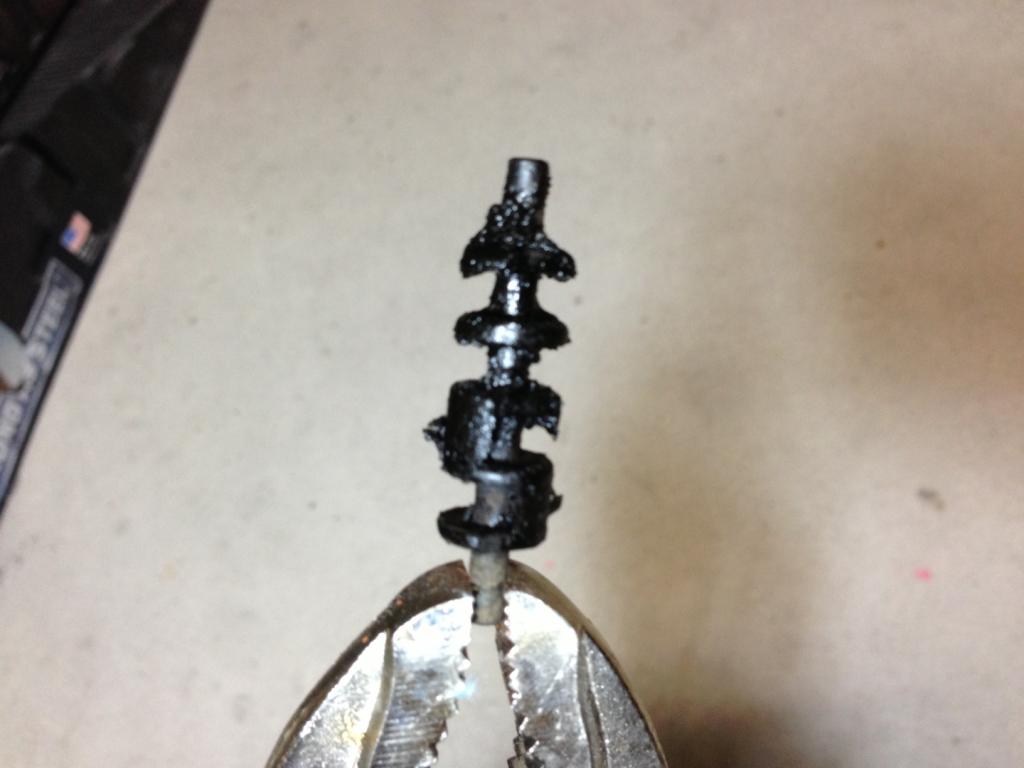

I have the upper/lower, intake, and valve cover gaskets in my cart at rovers north. After Mikes service list, rotella use, flushes, and very clean oil at changes, I'm just curious to see how it looks under the valve covers. I figure I'd replace the ignition coils while I'm at it, plugs and wires are new. Anything else you guys recommend I look at, replace while I'm in there? The head gaskets are new and I'm not having any problems at the moment. Any suggestions for cleaning the manifold and intake inside and out?

clean out / replace PVC in the vc

X2 on that, pix of the oil separator.

The oil galley drains in the heads can always use a probe with a rod, wire, or small caliber gun cleaning brush. If gunked, it keeps oil pooled in the valve covers longer than it should, and oil pan gets empty, oil light comes on at speed.

Buzz, you posted MY picture I showed you of MY dirty oil separator lol

re: Buzz, you posted MY picture I showed you of MY dirty oil separator
It was such a good example of what can go wrong, I went out and bought a new one. Mine was broken in half.
Glad I could help. You know what's funny, the picture only shows the half of the sludge that stayed on the separator. A lot of it fell off while I was removing it!
