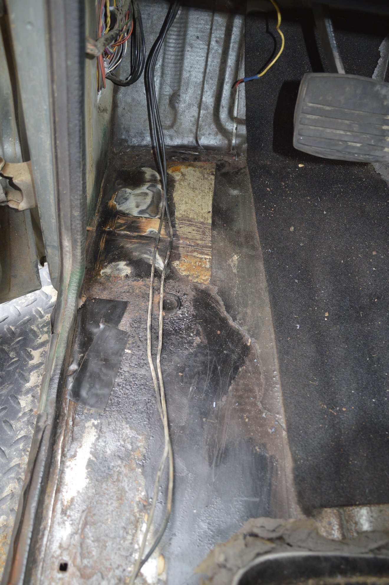

Well it is winter in southwest BC so there is lots of rain, I discovered my driver's side carpet was wet, not damp wet. Pulling up the carpet I discovered rust, it has damp under there for a while.
Water entry is above the brake pedal and wiring loom entry point, this is a fix for late spring as I will likely need to pull the left hand wing.
This is a big problem for our Disco's due to the 1 inch of sound-absorbing foam under the carpet, the leak hits the upper edge of the carpet and drains down to the floor pan saturating the foam, but the carpet itself will stay dry until the foam is soaked. It takes over a week of hot for that stuff to dry. To make matters worse there was some "asphalt" anti corrosion stuff on the floor that was old and also trapped water.
After cutting the carpet out, it looked pretty dire, but it appears there was previously hidden collision damage, the worst is at the front edge of the door sill and nice 2 to 3 inch rotten that needs to be cut out,the rest was largely heavy surface rust. The rear driver side also had surface rust just to make my life fun.
Repair is pretty straightforward, 2 pieces of 18 gauge sheet metal epoxied over the worst damage, using automotive panel epoxy and self-tapping tech screws. A small patch put into the hole and epoxied and riveted in place, prior to the primary patch. Then a few coats of paint over the rest.
Pictures forth coming.

A few images - front rust, note the torqued metal, the hole is under the flexseal tape.

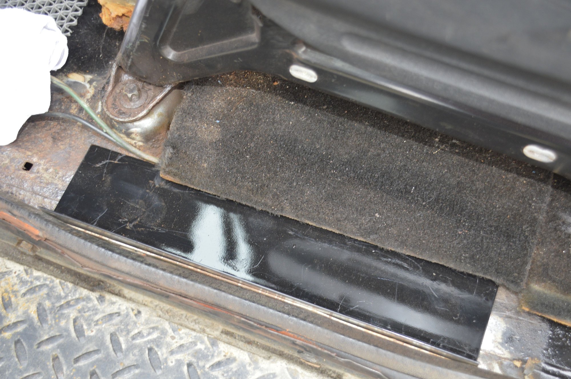

Front patch panel test fitted, and of course there is a bend

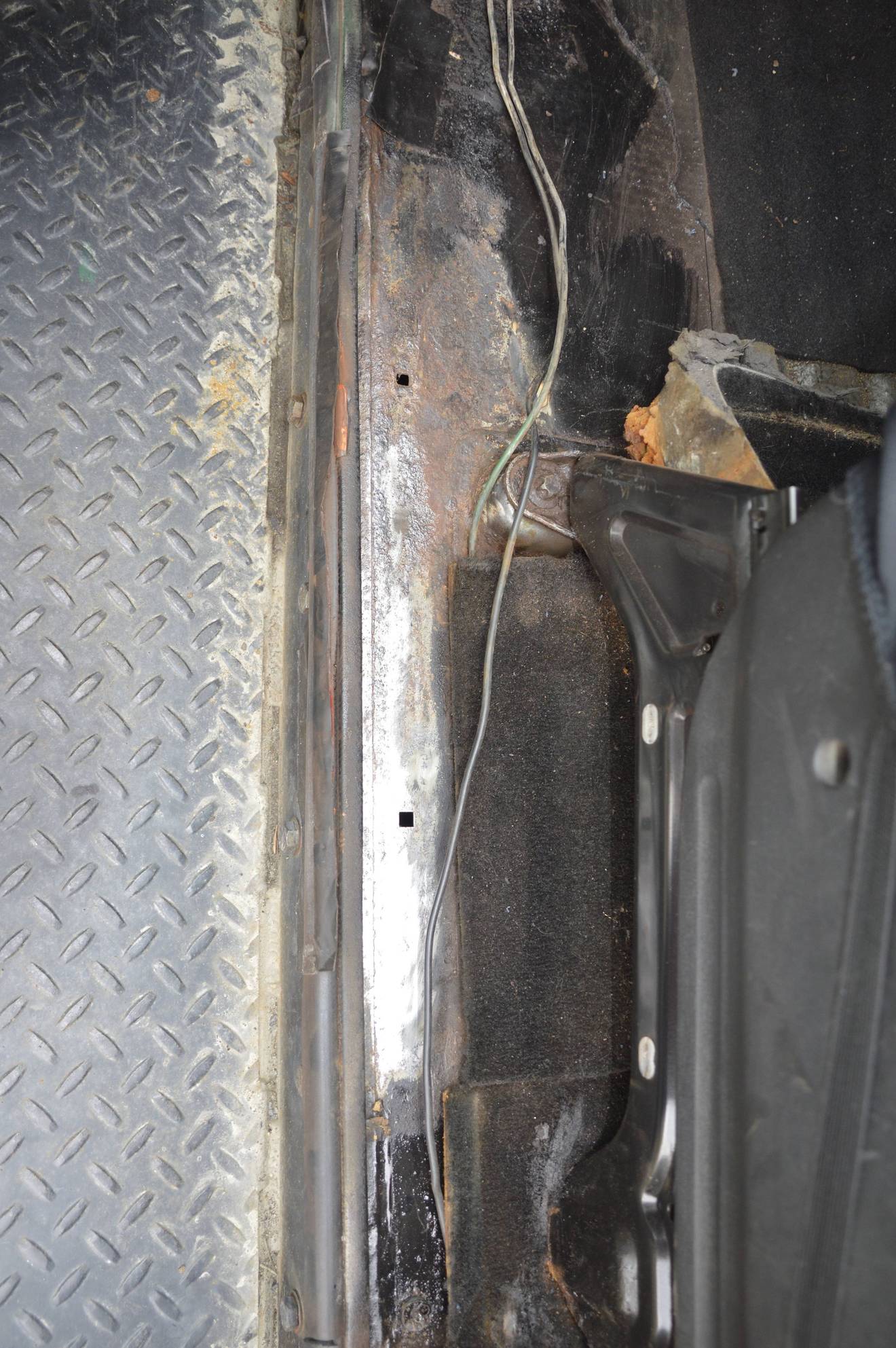

The section along the drivers seat and second patch
