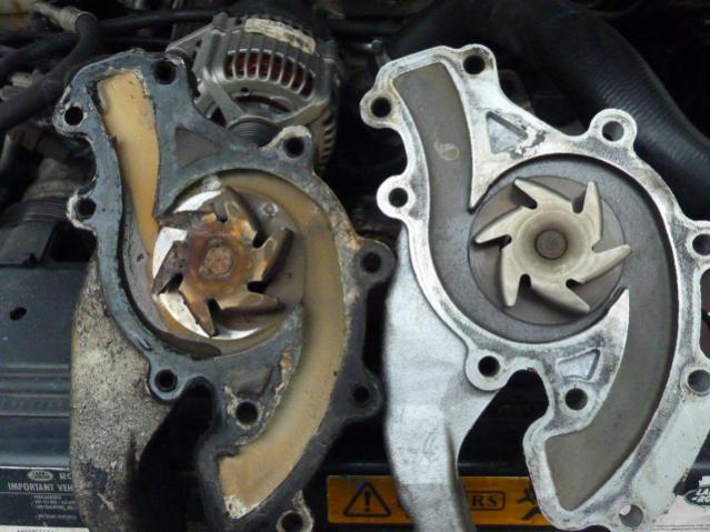

discotheque:
The PITA of purging air is more than offset by better cooling system health. See pix of what old coolant can do.... It is a mistake to not maintain by a schedule, if you wait until it's broke, you'll be broke, too. An overheated engine can be head gaskets, slipped sleeve, .....
