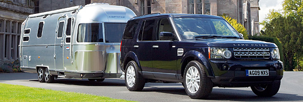

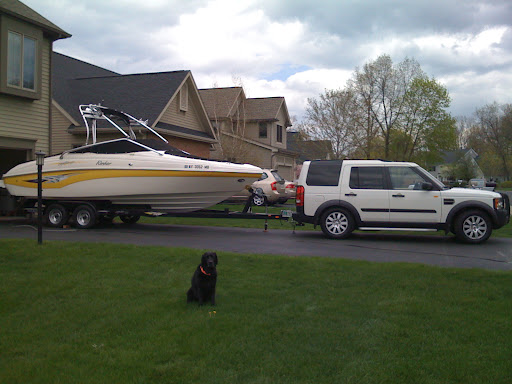

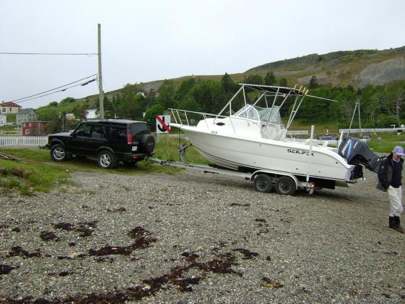

i cant believe people use these for towing haha... i can barely merge onto highways without causing accidents at empty weight
Old Apr 9, 2012 | 10:57 AM
Posts: 16,322
From: Savannah Georgia
They tow boats and plenty of other things, not always in a safe manner, but with style.... unlike some pickups!
