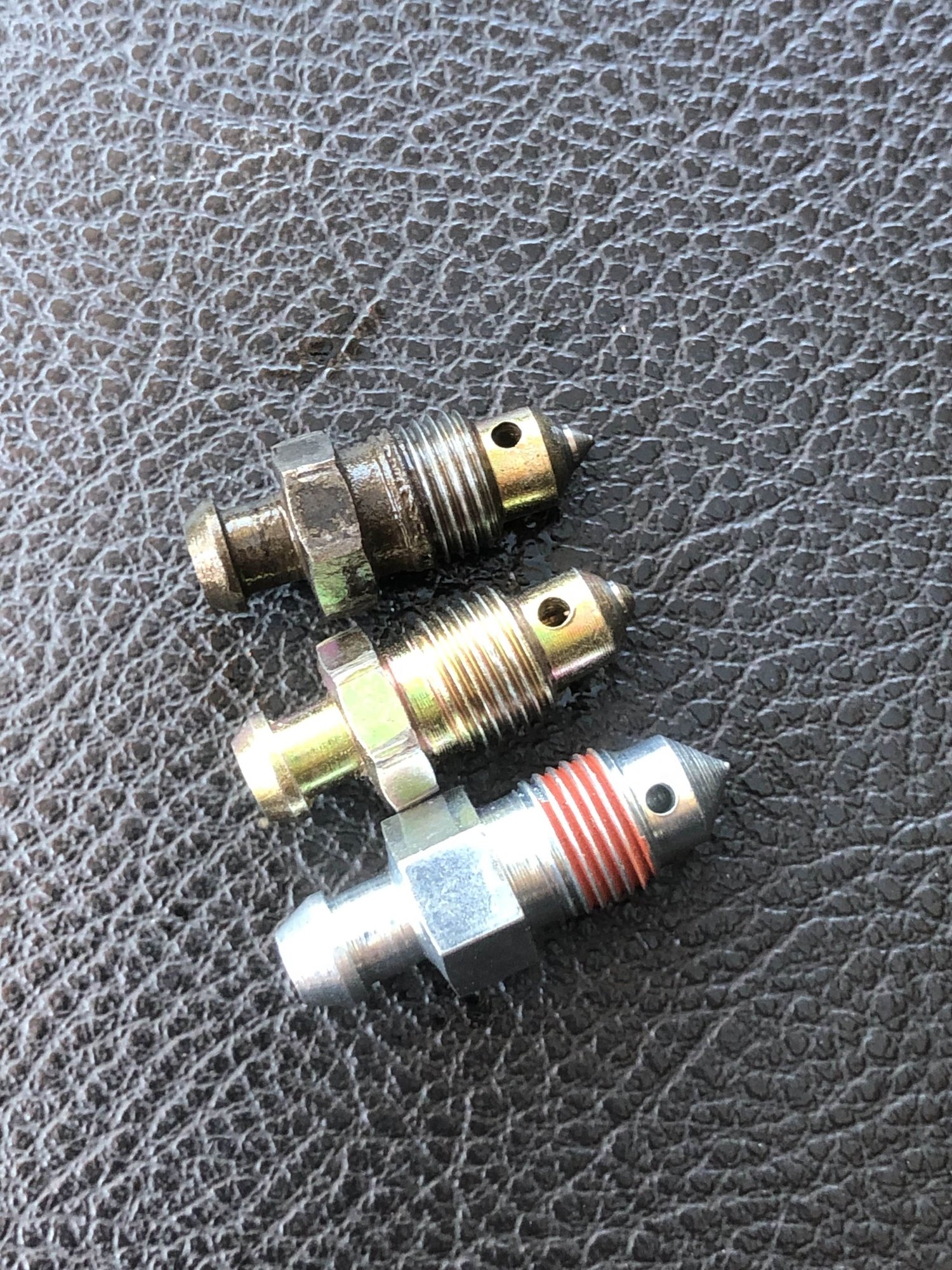

Question Leaking around brake bleeder screws.

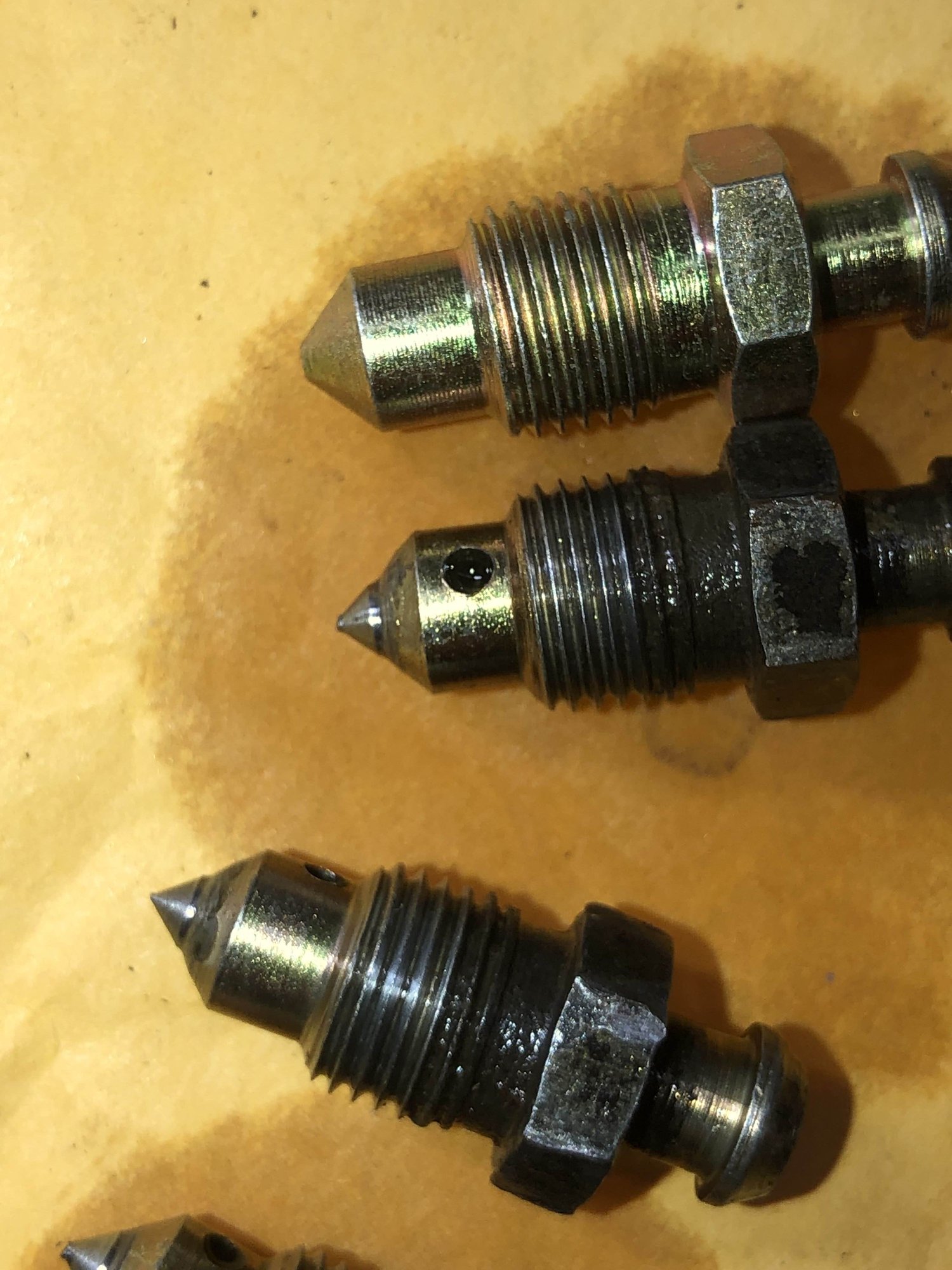

I bled my brakes 5 months ago, and slowly they became worse. I noticed that it was wet around two of the bleeder screws indicating a leak. I tightened them, and it became dry indicating it no longer leaked. I got some new screws and bled the brakes. I cleaned the area with brake clean so it would be dry around the bleeder screws, and after a short drive, all 4 of them were wet with fluid around it. I put the old screws back in, it seems better, but 1 or 2 screws may still be leaking (I need to drive more to tell for sure). What do I do? Will teflon tape fix it? Do I need to clean it somehow? Shown in the photo, the new screw looks a little different from the old ones. Did I get the wrong ones, or are the old ones just worn like that?

Looks to me that they've been WAY over tightened. We all know that buying parts made of Chinesium is a bad plan, also, mistreating parts made right is a similarly bad plan. Get some new good quality bleeders and replace them without over tightening. Know that you might also have damage on the seating surface in the caliper now.

I got the DORMAN 12706 bleeder screws (bottom). They worked great and are not leaking. The end is a little wider than the original screws, but it still works. The middle one was an aftermarket replacement from rovers north which leaked and the top is the original. I tightened the bleeder screws to 10 ft lbs.
