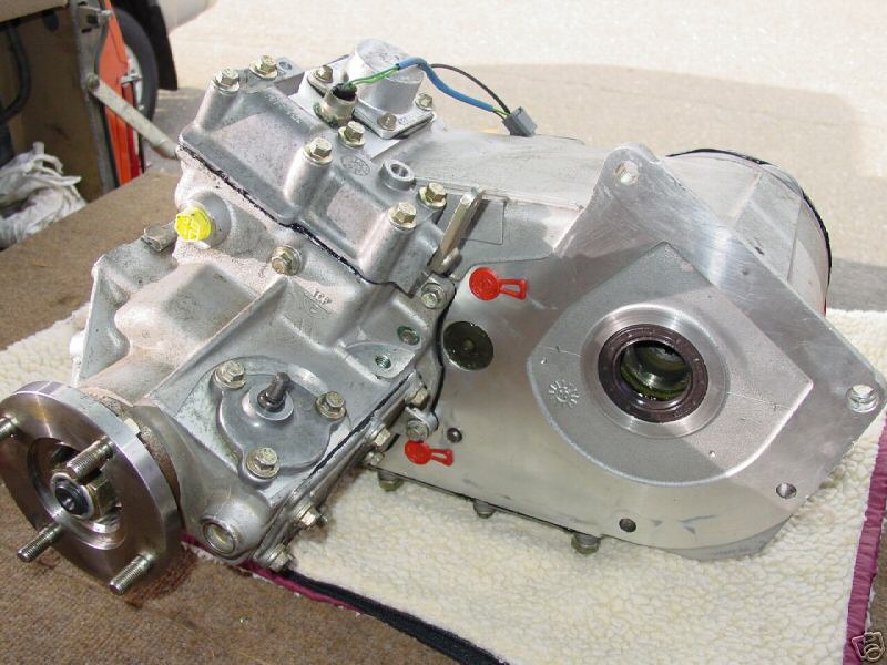

Originally Posted by Charlie_V
Where would the nipple be on the transfer case? I did have a warranty replacement of my transfer case but that was the same year I bought it (2000).
Look at this picture for the round plate, held down by 3 bolts, the nipple is in the middle of that plate.

Originally Posted by Disco Mike
If your t/case failed and was replaced under warranty, it probably won't have a CDL.
Mike,
That would be a bummer. It was replaced the same year I bought it, which was 2000. How can I tell?
