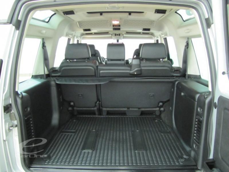

Are you talking about the floor vents coming out of the center console? Those are stock, but they use the front a/c blower. The rear a/c unit is attached only in the ceiling, no blowers on the floor.
Print out this picture just in case your dealer trys to tell you that the center console vents are rear a/c.
Good luck!
