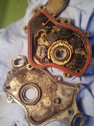

Here's a link for rebuild. It can be removed, drilled open, cleaned up, resealed. Of course down under they do this at the side of the trail on a flat rock with a bent nail and a tire tool.
Rebuild D2 ZF Selector Switch UHB100190 - Australian Land Rover Owners
Attached Thumbnails Looking for a XYZ Transmission Shift Switch-xyz-photo.jpg

Savannah puts my photo to good use. Lol

your check is in the mail....
