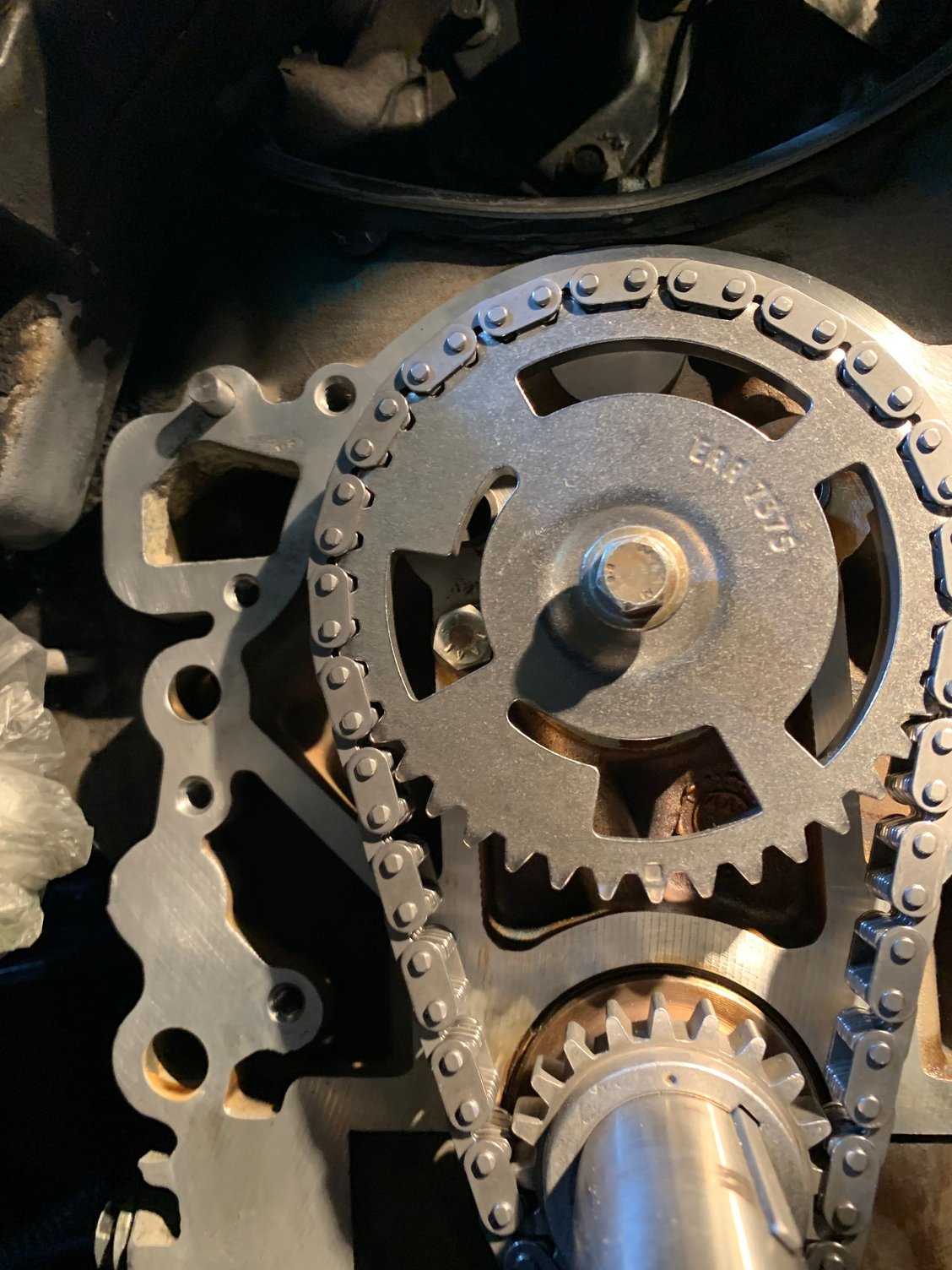

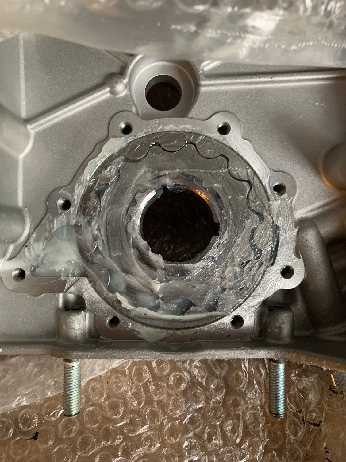

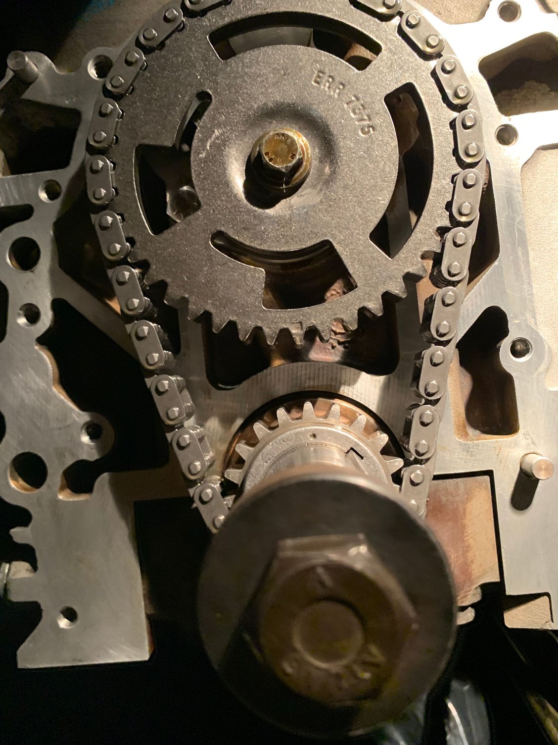

I was told to drip motor oil on the new timing chain to get it ready, but I’m sure I’ll make a mess. Soaking it in oil and installing it after also didn’t seem like I’d manage that without getting oil all over the gasket surface. How quickly does oil get in there with a new front cover (oil pump gears are packed with petroleum jelly)? Can I put petroleum jelly on the chain too? I have Sil Glyde, but it has silicone and I’m not sure if I should use that. I could lightly and carefully get motor oil on the chain and hope it’ll be enough until it gets oil from the tube… Planning to install the timing cover tomorrow. It’s already got the water pump on it - hopefully it won’t be a problem that I already torqued those bolts - I wanted to mount it to the timing cover and install them together for some reason.

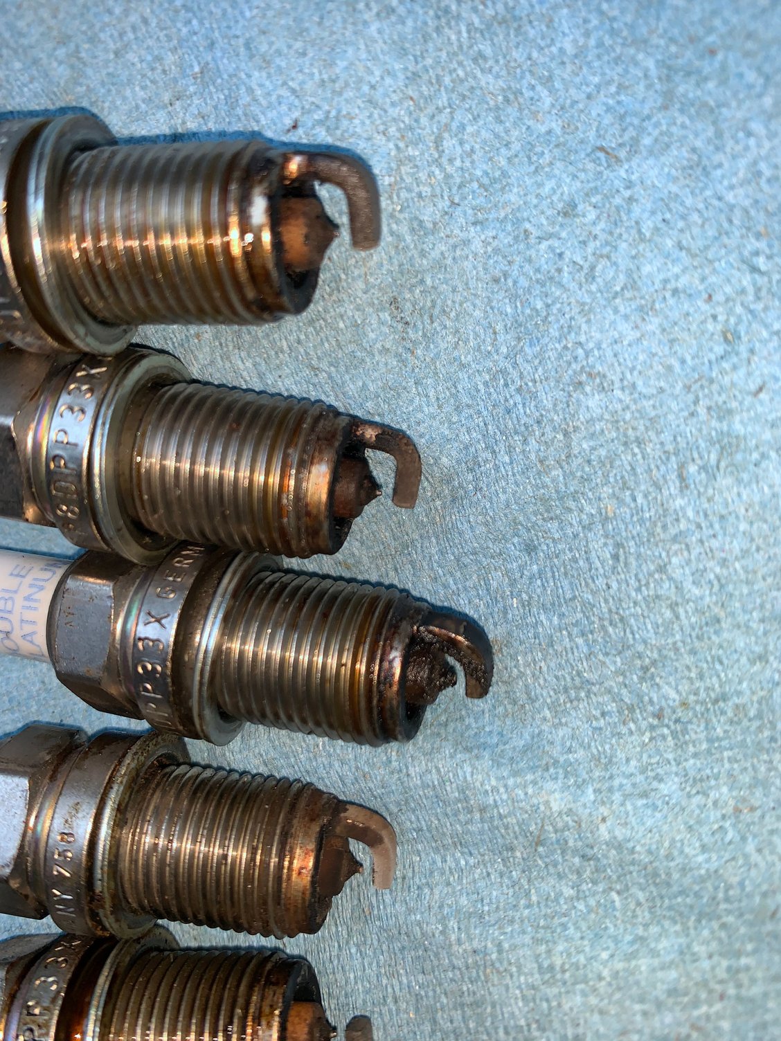

I’m wondering if I need to clean the spark plugs holes at all or put anything down there like marvel mystery oil since the vehicle has sat for a while? I turned the engine a few times today when I was installing the camshaft bolt to make sure everything was lining up - looks and feels fine to me, no collision or since I installed the timing chain the other day and needed to loctite and torque the camshaft bolt, feels smooth, marks on sprockets keep lining up, so I used loctite and torqued the camshaft bolt.
Someone a while ago told me I might want to use MMO in another vehicle (the 91 RRC) down the spark plugs holes since it’s sat for years - I’m not sure if that’s a good idea here as well or if nothing is needed? It looks like the spark plug holes are a bit dirty (some oil/carbon). I’m also wondering how effective those upper cylinder treatments are and if they’ll really blast that junk out of there somewhere.
Dry timing chain
A few plugs are pretty crusty

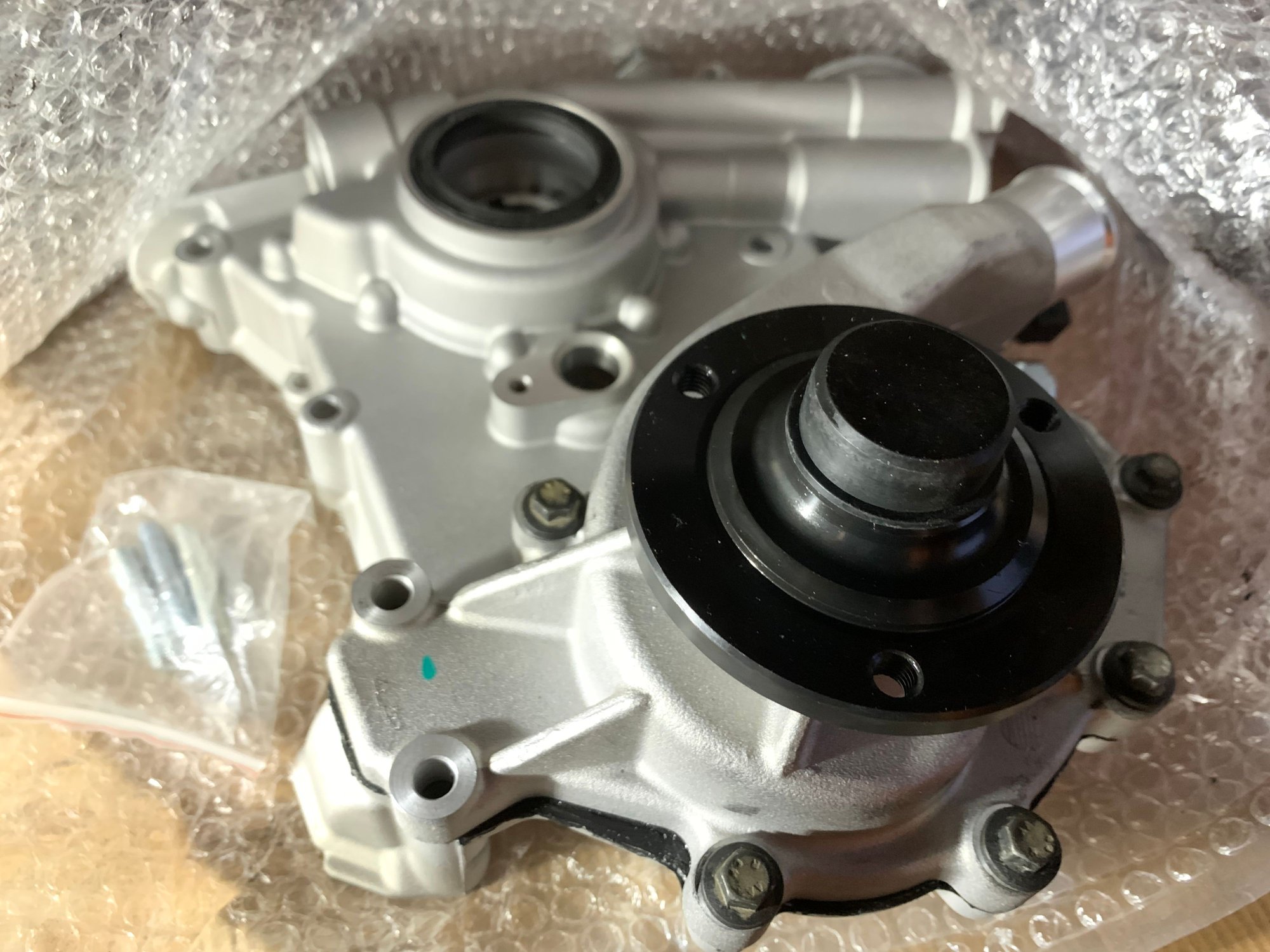

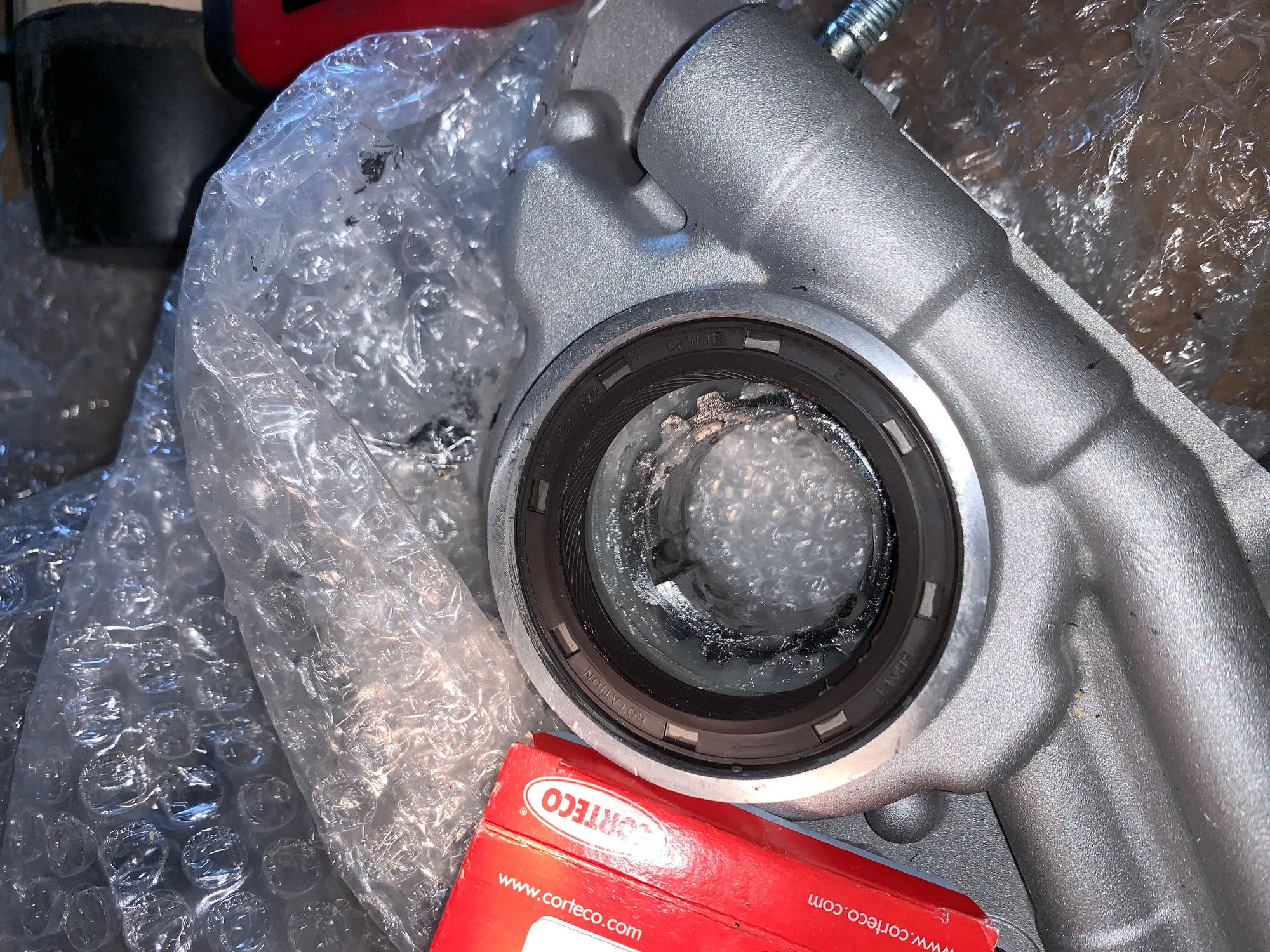

I was told to remove the SKP seal and use this one. Hopefully it’s installed properly - used black RTV amd pressed it until it felt right.
Packed with petroleum jelly following advice
Hopefully this won’t screw up the water pump gasket seal since I already installed it and torqued the bolts. Used black RTV - maybe I should’ve used red right stuff.

Old Aug 27, 2022 | 01:58 PM
JohnZo's Avatar
Joined: Apr 2021
Posts: 1,411
Likes: 397
From: SE Washington State

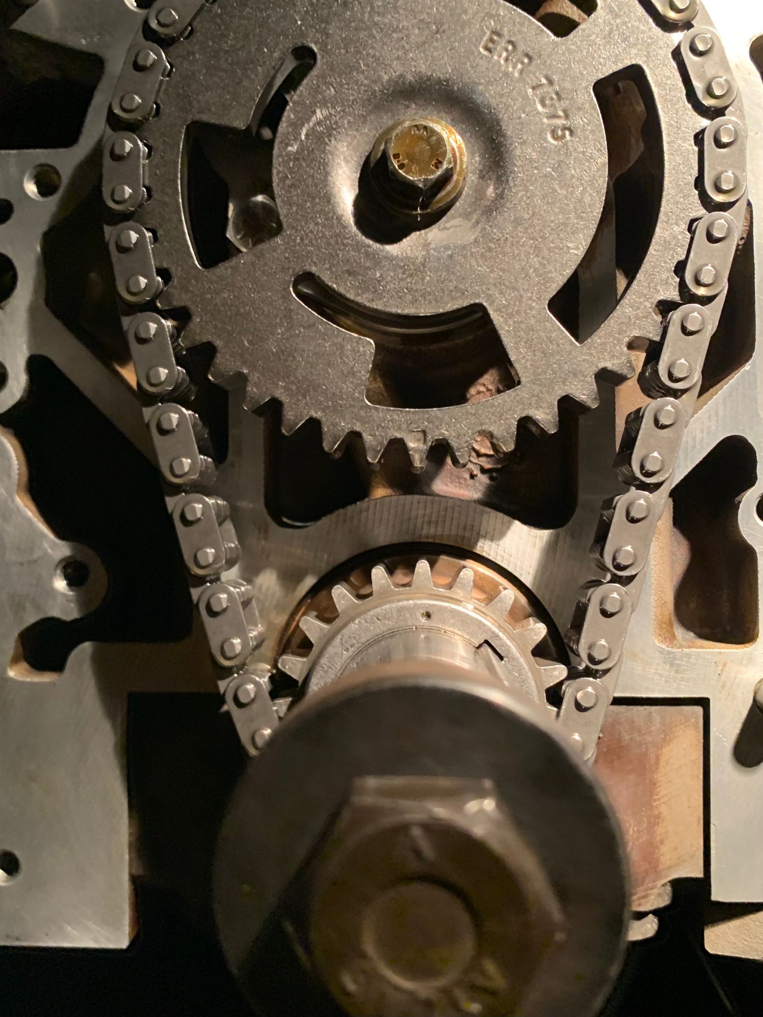

Maybe it's the camera angle, but it looks like the timing is off a tooth?????
Old Aug 27, 2022 | 07:02 PM
neuropathy's Avatar
Joined: Jun 2017
Posts: 459
Likes: 33
From: Los Padres National Forest
I think it’s just the angle since I have the marks lined up straight and turned the engine a few times. It seemed like there wasn’t really any way to even put the chain assembly on incorrectly. I rotated to TDC before removing the chain and put everything back exactly how it wanted to fit with the keys. The cam sprocket was difficult to remove and require some rubber mallet tapping to get back in. I bolted it back in after checking that the marks kept lining up straight with every two rotations. I sort of figured that bolting (torqued to 37 ft lb with loctite) the cam sprocket would sit as it should in case it was a bit proud or angled slightly (since it didn’t slide right into the key). The crank sprocket slid right on easily, though.

Old Aug 27, 2022 | 08:54 PM
JohnZo's Avatar
Joined: Apr 2021
Posts: 1,411
Likes: 397

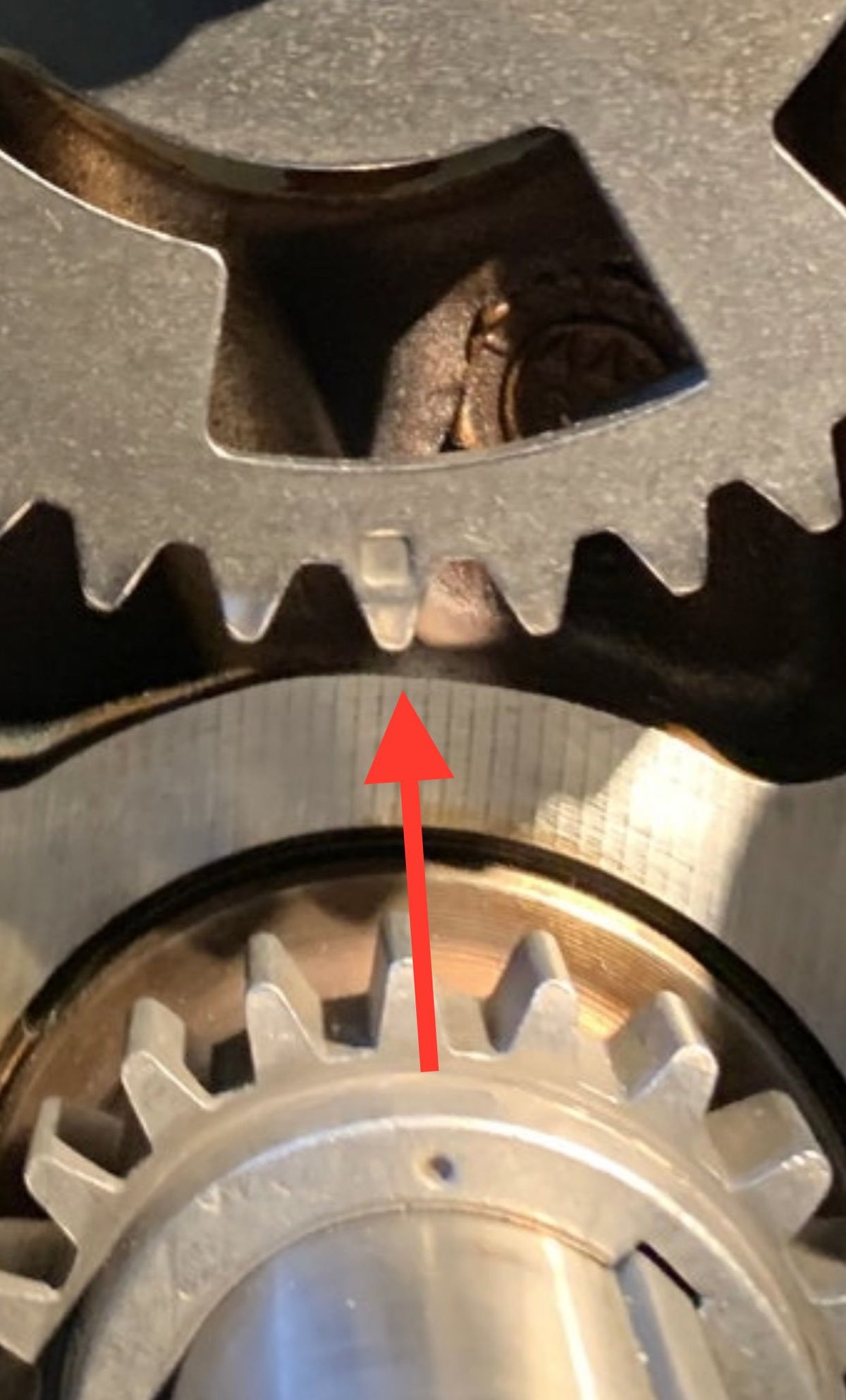

Sorry to keep after this, but we really don't want to have to open her up again, so just triple checking the timing marks. Notice the crank mark is actually between the teeth. And it can be put together wrong if things moved a little.

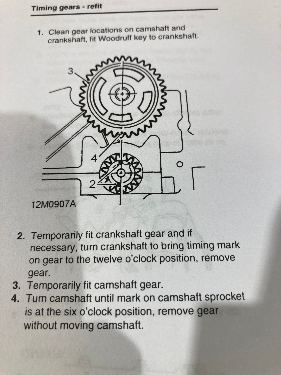

Rover V8 timing chain alignment
Old Aug 27, 2022 | 10:34 PM
neuropathy's Avatar
Joined: Jun 2017
Posts: 459
Likes: 33
Thanks for helping me check this. I’m pretty sure it’s aligned, but it’s hard to get a good picture of it. I turned it again and I think it’s right. By the way, the camshaft bolt is supposed to turn with the sprocket right? Probably a dumb question.
Old Aug 28, 2022 | 12:47 AM
neuropathy's Avatar
Joined: Jun 2017
Posts: 459
Likes: 33
This image might be better. I don’t think it would even let me put the chain on one tooth off because of the keys. I rolled to TDC before removing the chain and didn’t move anything. I put the new chain on as an assembly and when I was getting the chain on the sprockets, when it was a tooth off, it was very clear that it was off, so I’m pretty sure it’s aligned. I rotated the engine about 5 times and it feels fine to me - doesn’t feel like it’s colliding, making noise, being too difficult, etc. Thanks for helping check this.
