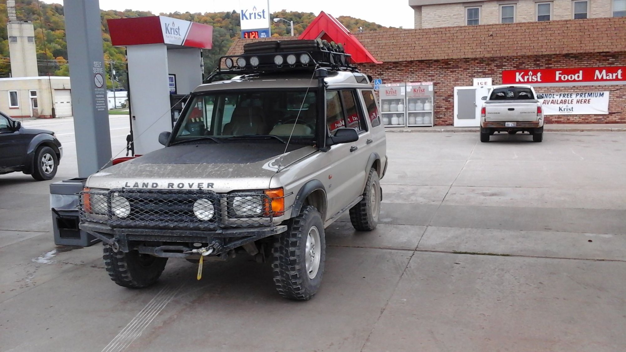

Went with medium on my 01, wish l'd have split the lift and went with front medium - rear heavy duty. When loaded for extended travel, week or more...she sat a little lower than expected in the rear. No steel bumper in rear, but had sleeping compartment inside...which was over a hundred pounds (but rear seats were removed, so pretty much a wash). Now, if it was just me, no other person's gear or extra supplies...the medium TF lift and shocks were fine.
This was my daily driver for two years, 35K, and it did ride nice with the medium lift.
