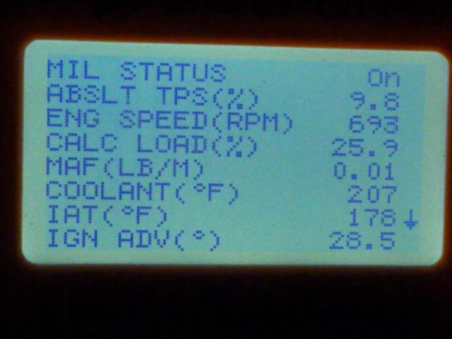

ECU problem? Seems like something must control spark advance. See pix of a scanner monitoring real time data, that one at the bottom should change, as do many of the others, under changing loads. If you have or can borrow a scanner, have co pilot write down readings from several things while you hold the vehicle at various speeds and loads. Almost as dangerous as texting while driving. Might point to something, like sensor ECU uses to determine camshaft position, etc. Ignition items are covered in detail in the electrical troubleshooting guide of the RAVE.
