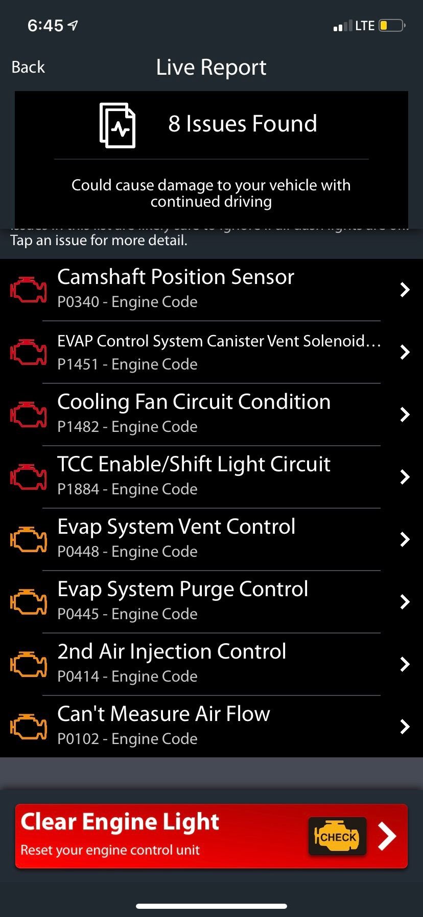

I have multiple codes going off on my Land Rover and I can’t seem to find the problem.
could really use some help with this

Those are generic codes, you need to look them up specifically for a land rover. Does the truck run ok? The TCC is likely a battery voltage issue, my guess is the other major issue is a MAF issue

my truck is a 2004 Land Rover discovery 2. She has a problem starting but once she starts it runs rough and fuse number 2 always blows

Sounds like a MAF, don't remember what fuse #2 is. Look up the codes for LR specifically.

fuse #2 is the engine management fuse and is a 15 amp fuse

Do you have SAI?
Also check the wiring of your O2 to see if they are grounding out. Usually the right downstream O2 sensor wire will rub on the drive shaft.

if SAI stands for secondary air injection then yes my truck does have SAI and the wiring for the O2 sensor is still in good working order.
