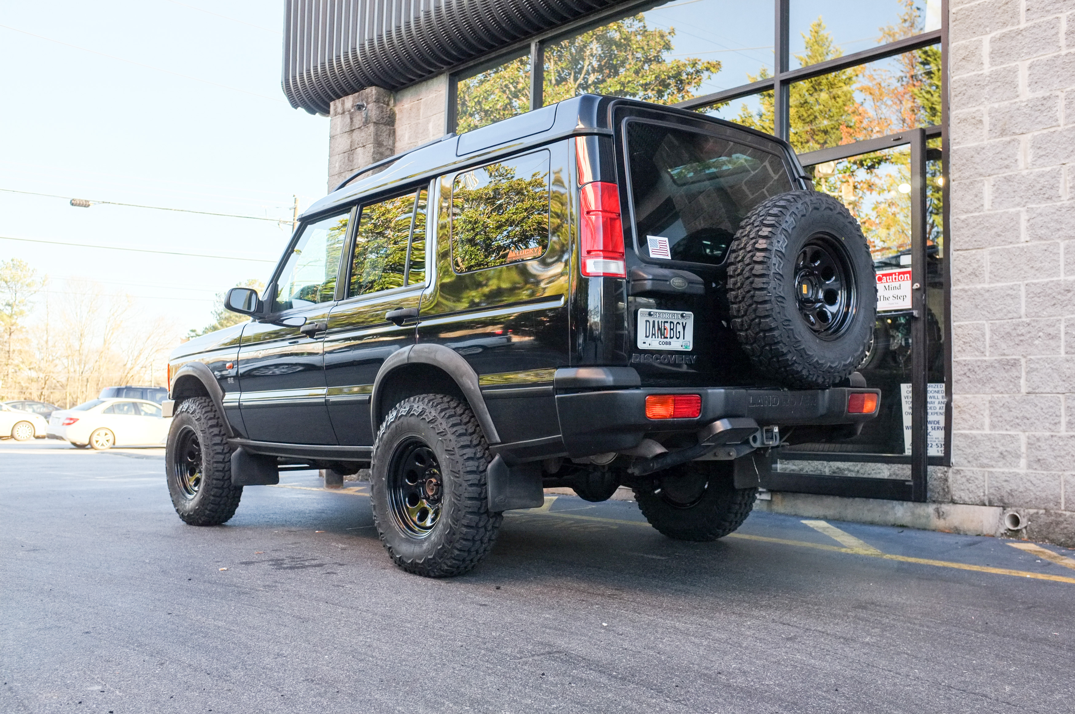

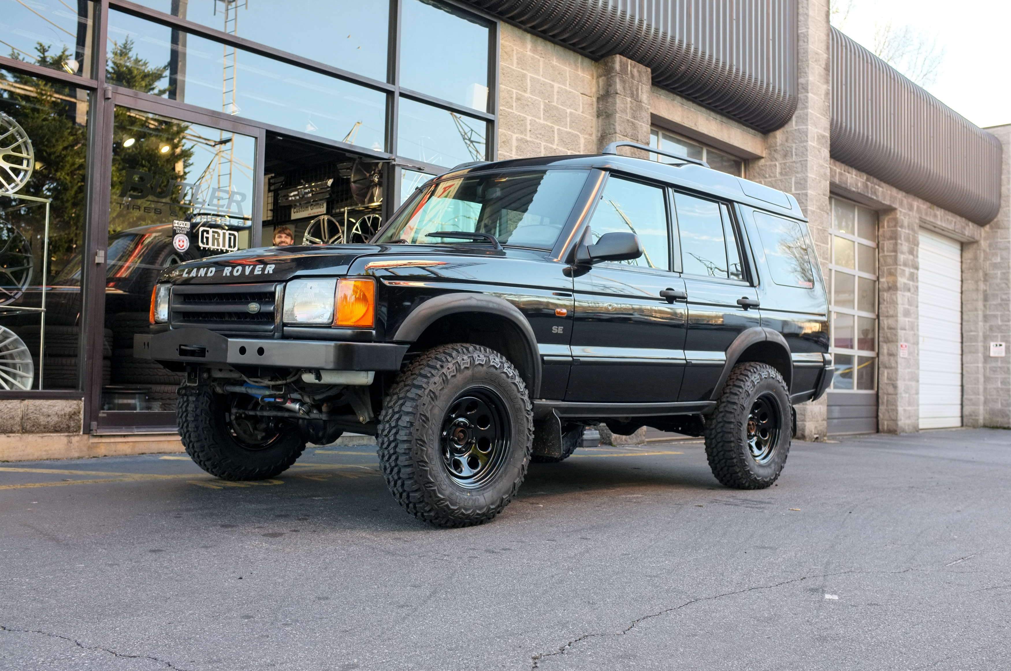

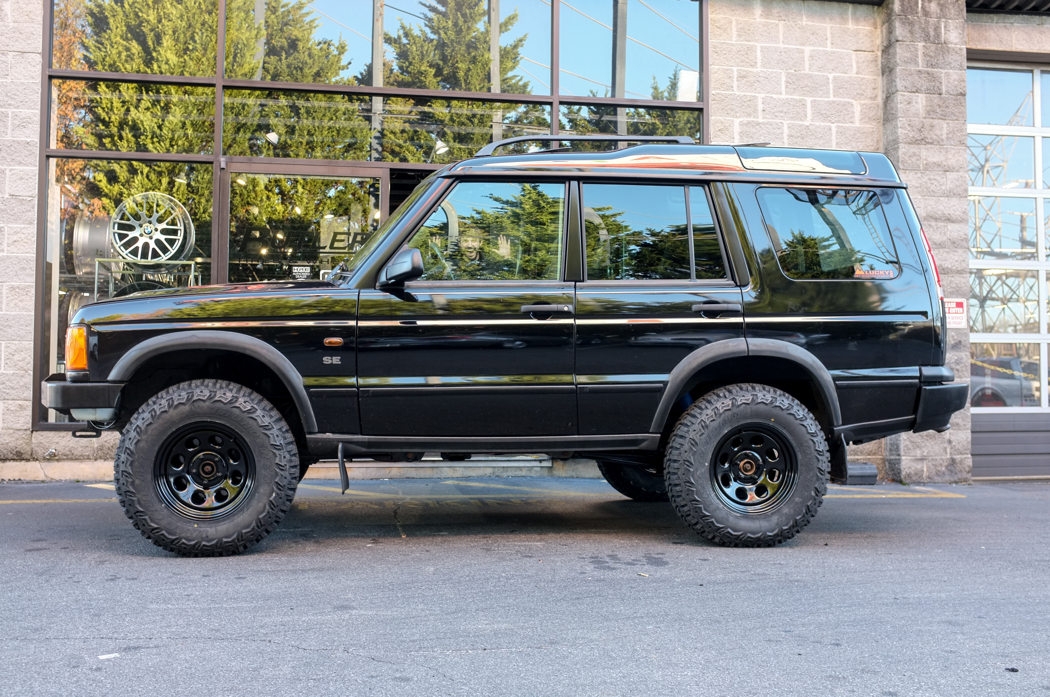

First phase done!
Terrafirma 3" lift plus stabilizer, 16x7+0 Cragars and 235/85/16 Thunderer MT's installed. Lots more to do, but she's not looking too bad, considering I have $2,500 into her so far, huh?

Cool thread. You suck.
I love reading about folks who get deals like this and make it really cool. Well done (but you still suck as I have double your total investment in now and only mildly ahead of you, save the bumper).
Speaking of bumper, what about the washer fluid tank hanging down? Is there a fix or relocation for this? And you are making me think more and more about doing a mild lift on mine. Oh yeah, with the larger tires, any noticeable difference in performance? Do you think you ned to re gear?

LOL, thanks! Yeah I know I got lucky! I had a legitimate offer for $5,500 last night that I turned down. I just love this thing so much.
I've seen a video of a guy that relocated the tank to the rear passenger side of the engine compartment, so I eventually plan on doing that. Regarding gearing - no plans yet, as financially it doesn't make sense as this is a toy that will rarely go deep off-road, just light stuff. As far as performance, it's definitely slower, and that's saying something! The tranny has to shift a lot sooner to maintain speed, but I was ready for that.

Three questions if you don't mind.
A: what exactly makes the terrafima lift 3" as apposed to their 2" or OME's 2"? Is it just their "heavy" coils?
B: do you know how much that front bumper weighs?
C: do you know the backspacing on those cragers?
awesome rig so far for so cheap.

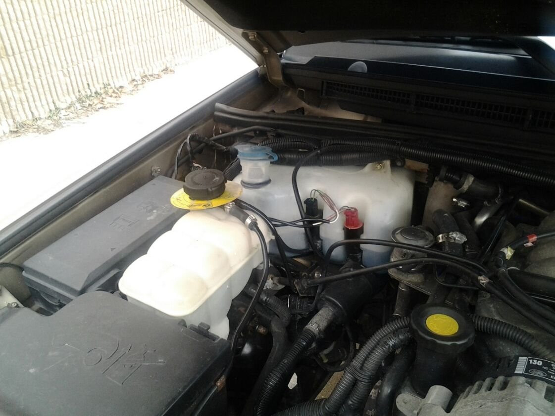

Relocated my washer bottle, pretty easy, just removed my SAI pump, made a couple small brackets and hung it on the firewall, rerouted/extended wiring harness and hoses, shorten filler tube, relocated interia switch...took about two hours total.

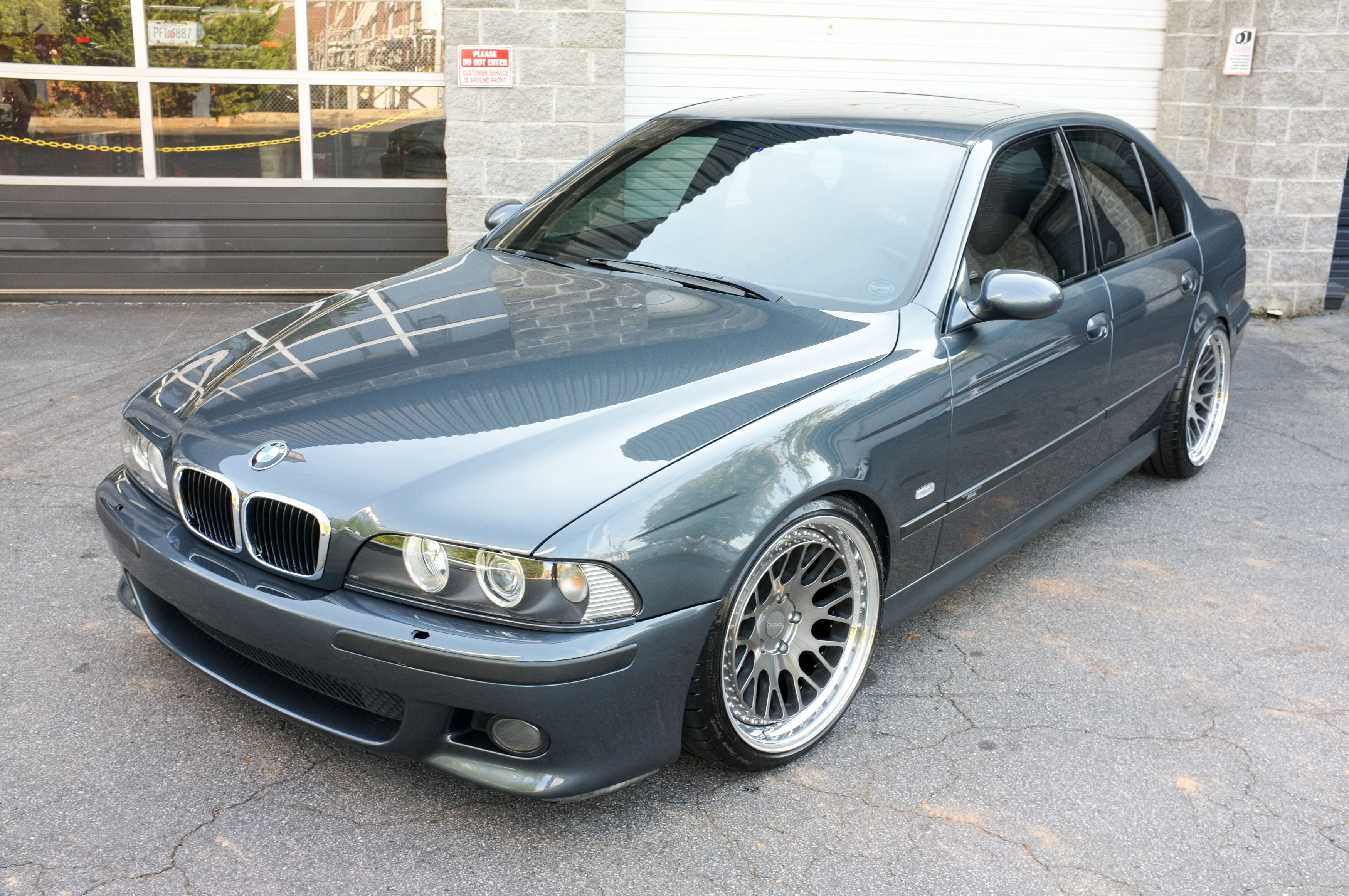

Awesome. The garage queen is my E39 M5:
1. Yeah, just longer coils. Shocks are the same. You can get their upgraded kit with longer rear brake lines and sway links, but the standard 3" looked good for me as I doubt I'll ever be at full flex in this thing, just light forest service roads.
2. Front bumper was pretty light - I think the shipping label said 75lbs.
3. 16x7+0 so, 4". +25 would have been a better fit, but they were backordered forever and these were super cheap - $396.60 shipped for five of them.

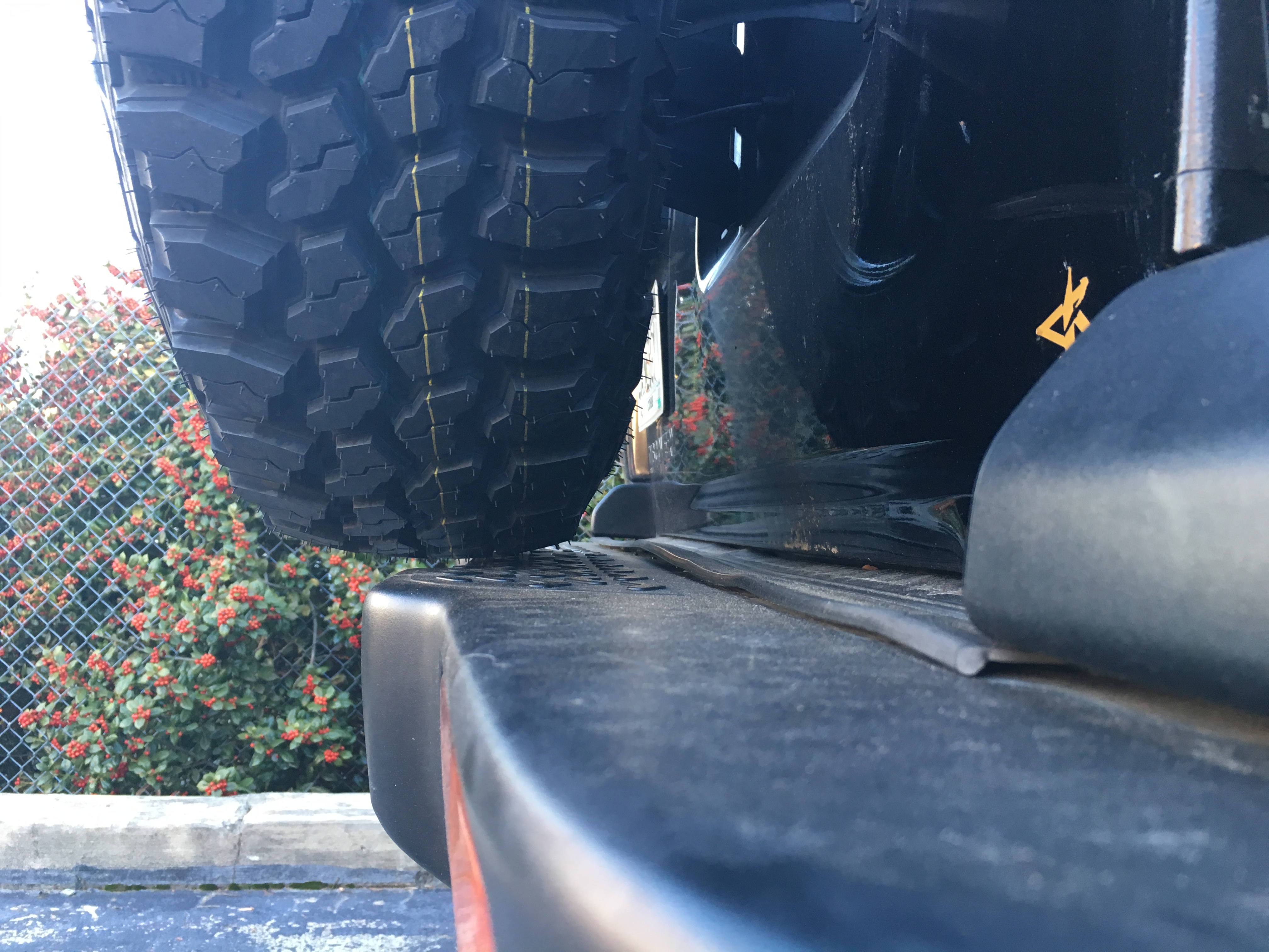

How much clearance between the rear mounted tire and bumper?
Was thinking about 235/85's...but the door opening and closing concerned me.

Thanks! I think you're the one that had the video on Youtube, correct? If not, that was the same mod I plan on, thanks!
And I flipped the rear carrier upside down, per recommendations on this board (God I love forums), saved me $100 for a relocator:

Sorry for the thread jack, but what did you do with the SAI pump? I've got one and don't really know much about it. Can it just be removed?
