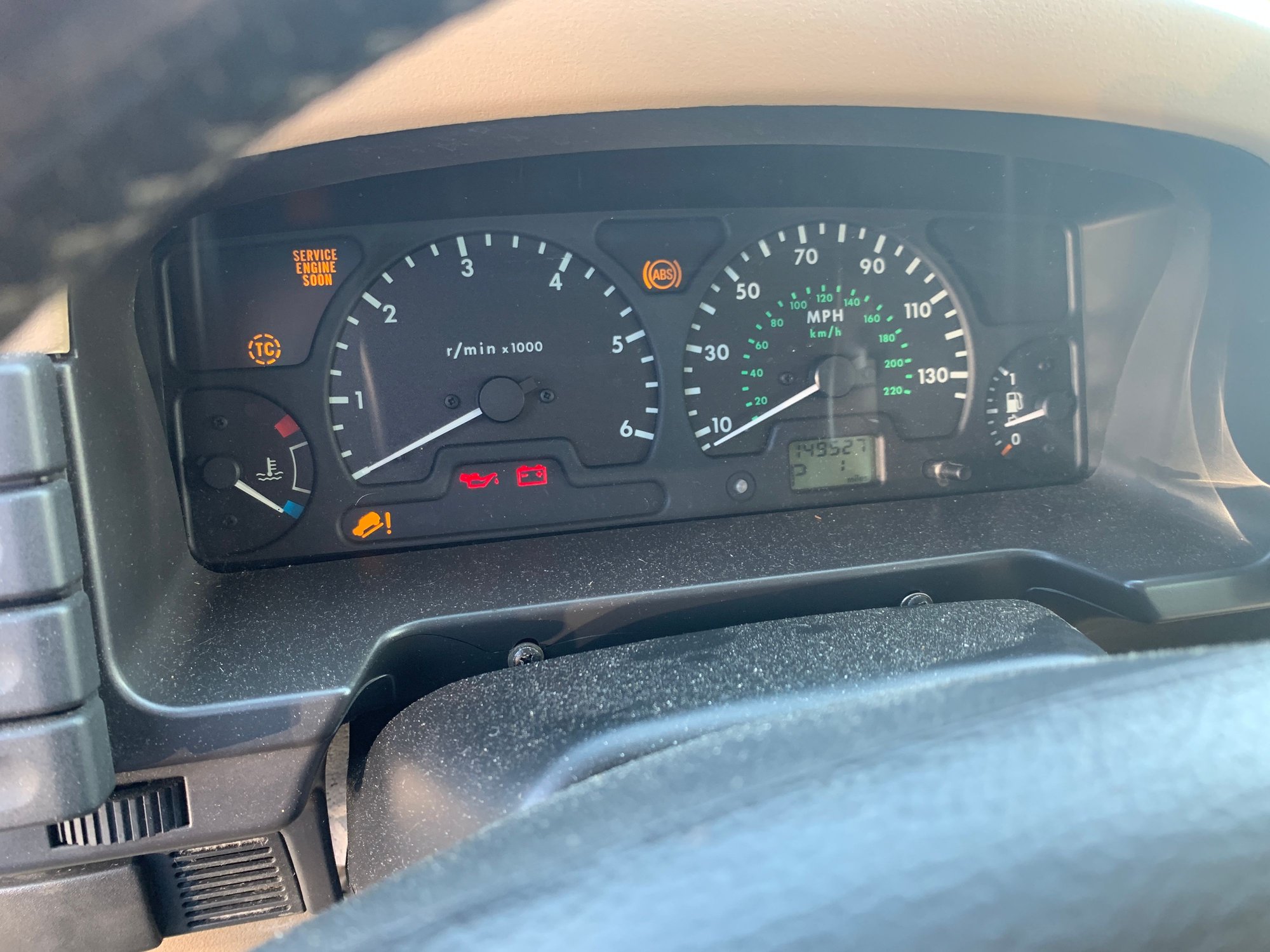

I took my disco in to get a key reprogramed. During the process, the mechanic messed something up and now the car will not start.
It will turn on but when moving the key to the start position nothing happens.
Is there anything that I can do?

Sounds like he needs to go thru the BCM settings and verify settings. Also is the red light flashing like crazy when you try to start it?

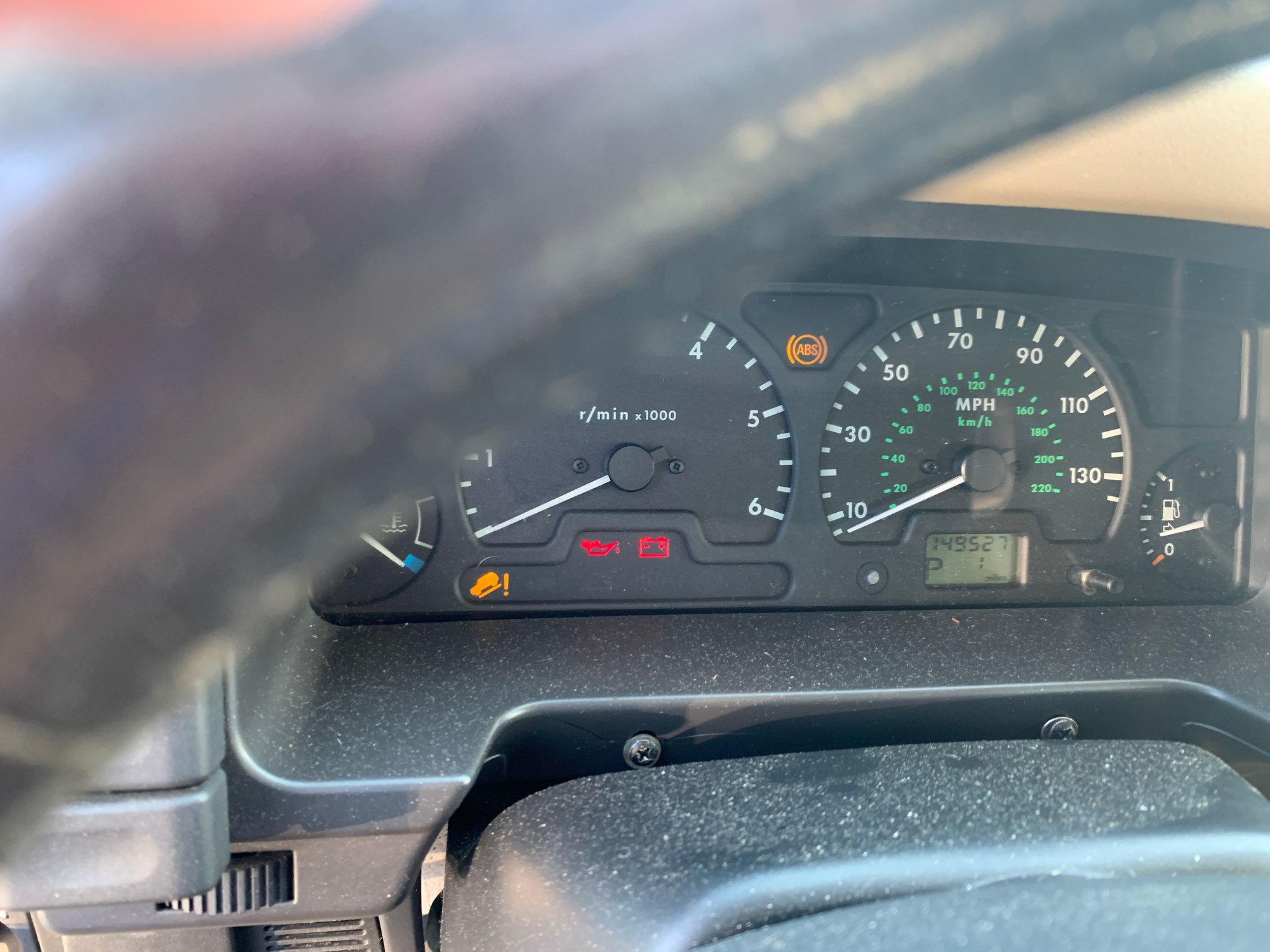

The light just flashes at a slow pace. I have also tried the eka process with no luck. I got the number from the BCM

Here is a link to the video
https://www.dropbox.com/s/fvi8d5mx7k...%20AM.mov?dl=0
