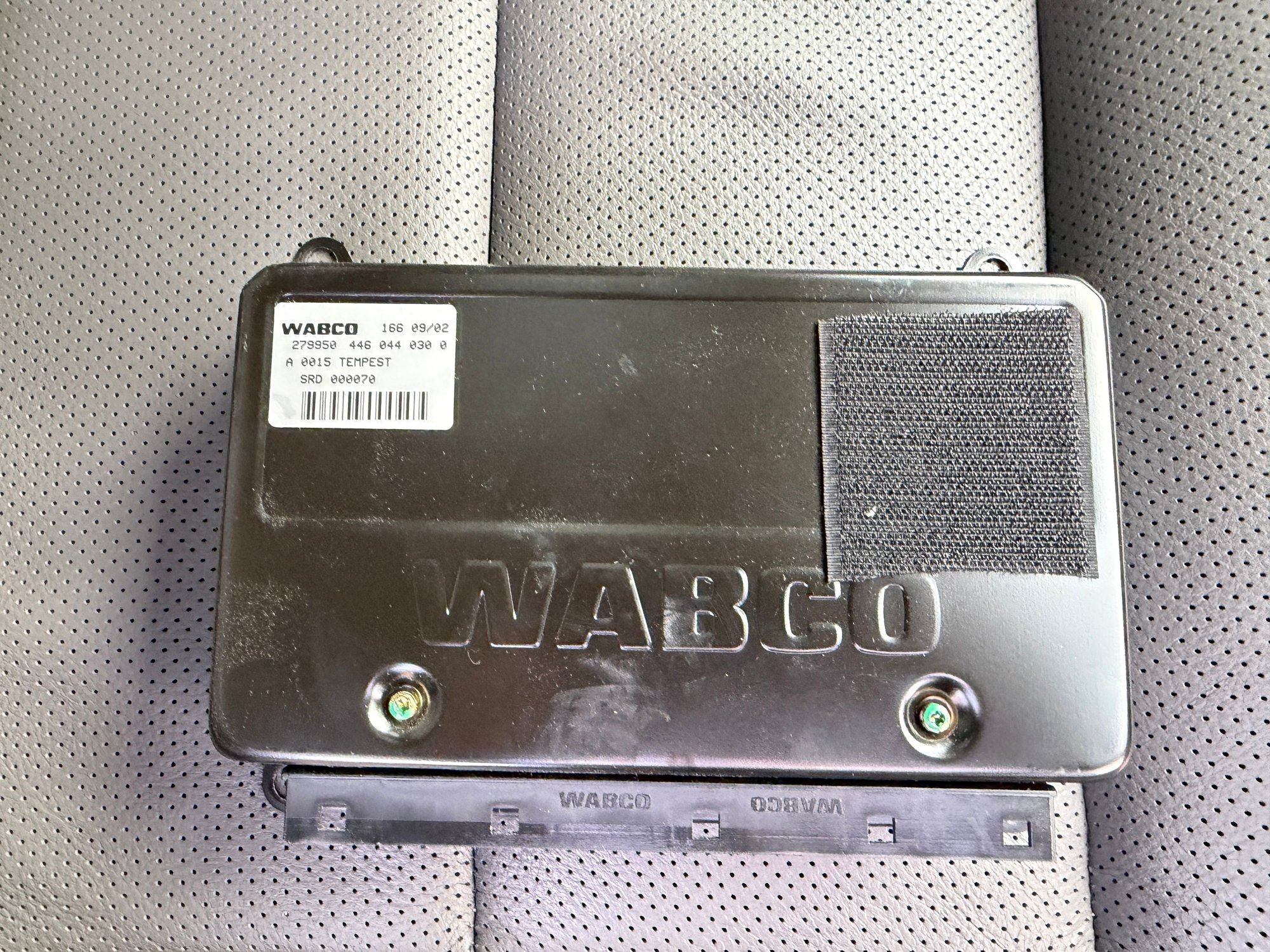

This truck came with SRD000070, date code 09/02, so it was replaced under warranty recall.

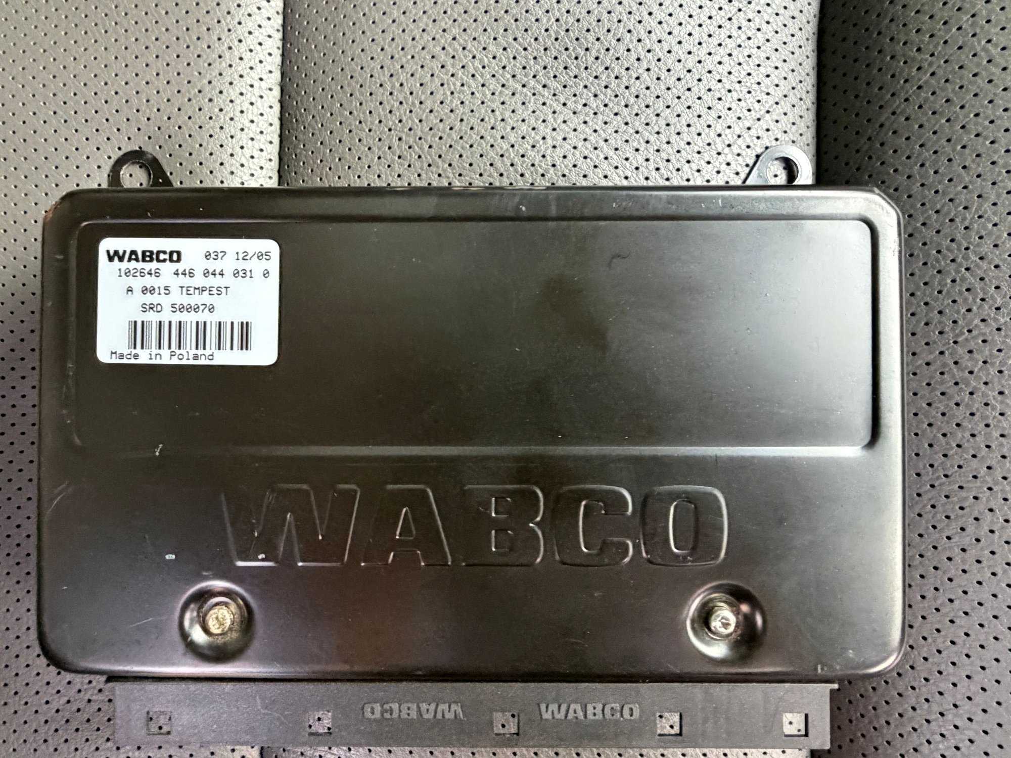

At the PCRC annual chili cookoff and parts swap, someone was selling a used SRD500070 with no corrosion on it, I picked it up for $30. A steal considering most 500070’s online are far more expensive (used or new, and hard to find).

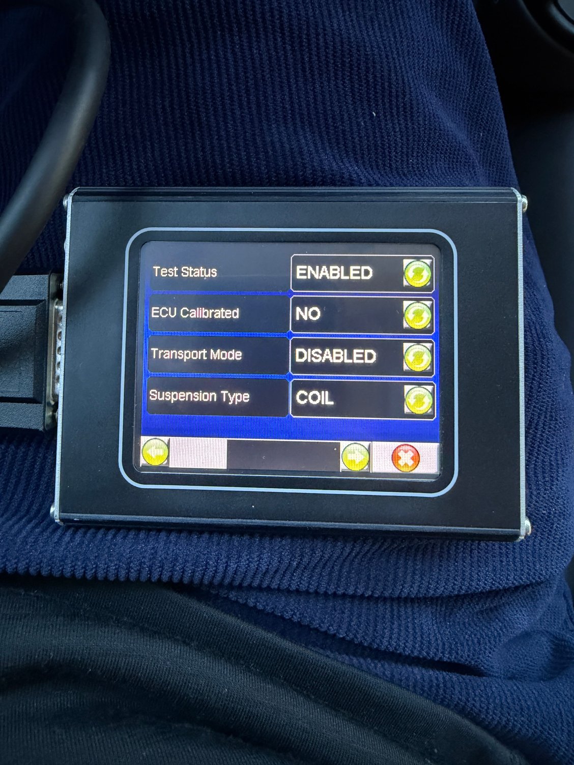

The new SLABS came from a coil spring truck. I initially saw the same Engine Speed PWM code I mentioned earlier in this thread, which did not inspire confidence, but it said 001 time, and it cleared without returning.
I then changed the setting to AIR and recalibrated the heights. The “ECU Calibrated” status switched itself to Yes.

What I saw on the SLABS when I first powered it up in Nanocom
SRD500070 - the new one
SRD000070 - came with the car although not original to the car.  I wonder what the velcro is for?
