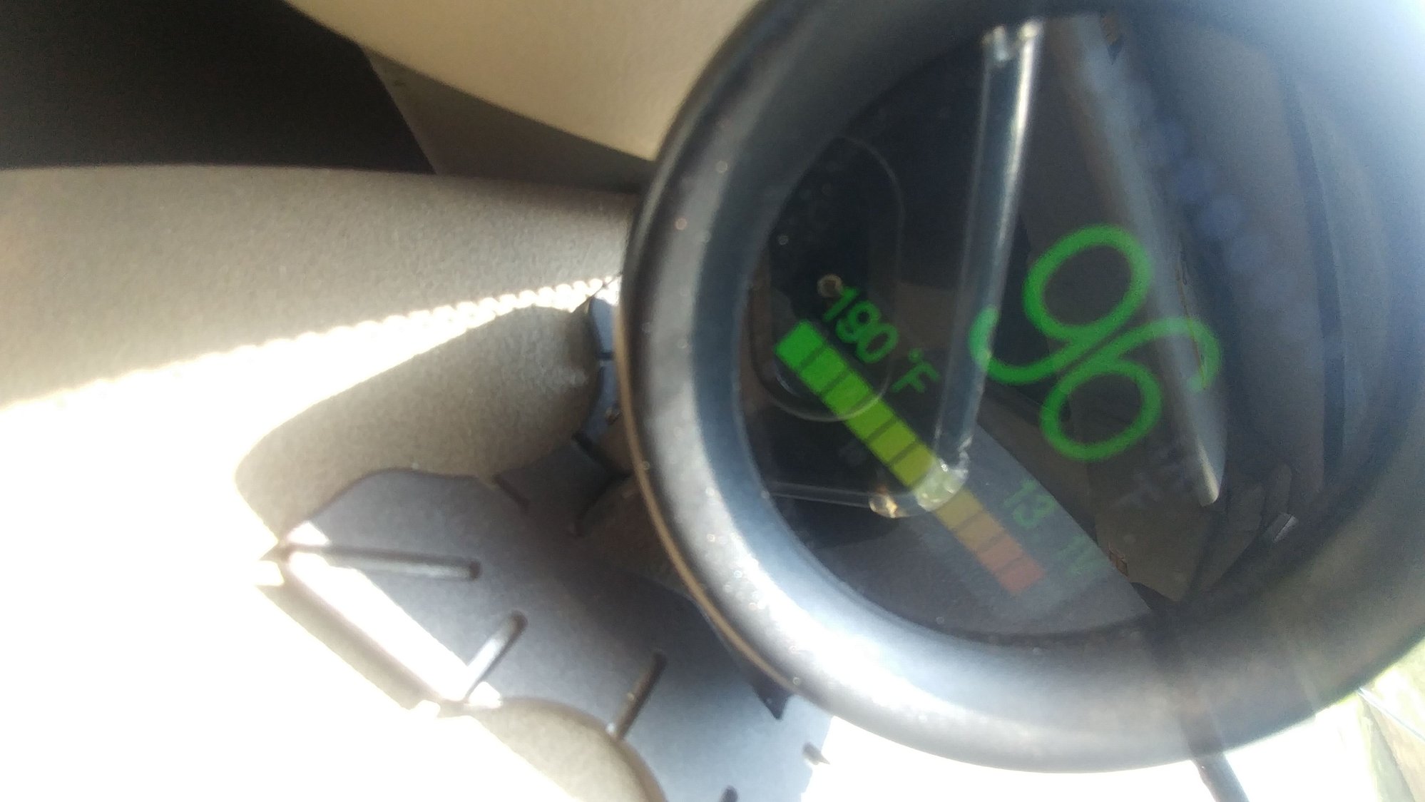

I've I've got the kits for the inline thermostat, send me your email address and a private message and I'll send you the installation instructions so you can look it over. Here's my experience with the inline thermostat today. I'm driving from Lynchburg Virginia to Charleston South Carolina going down on I-95 and it's hot today, I'm reading air temperatures between 96 and 98 Degrees, truck is running 194 degrees with the air conditioning full blast going 75 miles an hour. the truck is a 2000 with 250000 miles on the clock with the original engine, she has a safari Grill and I run with both of the weather strips at the back of the hood removed to let the hot air out of the engine compartment

I just I just had to stop for gas, 313 miles on 18.97 gallons going 75 miles an hour, that 16.5 miles per gallon on a 20 year old truck with 250,000 miles on it
