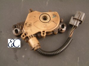

Alright got the old switch back in, can't figure out how to adjust it. The key is stuck in the ignition and won't register in park. Is it a bad switch ?

To clarify, the XYZ switch you adjusted and put back in is on the side of the transmission?

I believe so. Could it be a faulty switch? And not sure about the adjustment? Will not go into park.

There is no adjustment on the XYZ switch.
Open it, clean it, lube it, seal it, put it back.

The mounting points for the XYZ switch are slotted and without the Land Rover alignment the job will require two people. One person in the cab reading the shift point (key in position two and selector in D to start) and the second person to tighten the switch at the proper location.
FYI - We had a bear of time because the switch would lose its alignment when the truck was at operating temp. A suggestion would be to do this when the truck is at operating temp. and be careful of the catalytic converter.

Ahhhhh, I thought he meant adjusting the insides.
Thank you for the clarification.
