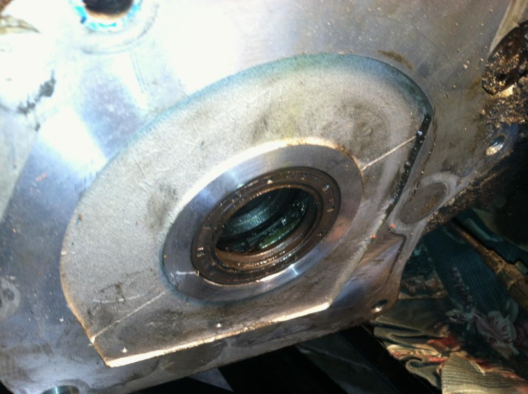

Considering my original tbox went with a blown-up transmission output bearing it would just suck if the used one I picked up has the exact same problem looming. When the original one went it just imploded with zero prior noise. Either my last t-case imploded and fried the tranny or the tranny fried and blew the t-case bearing. Either way they both were NG and I had to replace them both. Keep in mind I drove this around for a couple of weeks after the replacement with NO noise. This just came on out of the blue and I have not driven it since. Here is a pick of the t-case I pulled out with the toasted bearring...........
Attached Thumbnails Name this Noise video :(-gbtranny2.jpg
