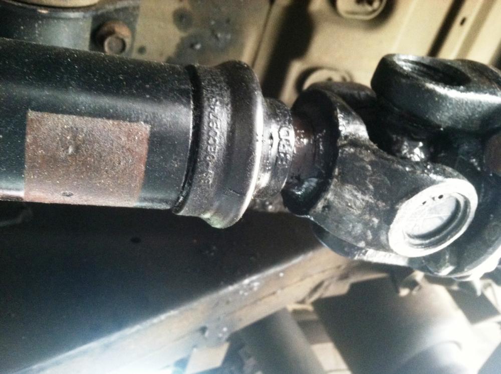

Well Jumpin Jimmeny fn time I have fixed this crazy noise issue.
Got it all back together and it was the damn output bearing after all. Pretty straightforward job all in all. But dumbazzz me forgot to put the giant washer that goes behind the lock nut and in front of the flange on. I was wondering why I had so much thread left on the shaft. I original thought I did not press the splined shaft in far enough but thought impossible the bearing was on all the way and the circlip fit perfectly in front of the bearing. So off comes the shaft for 400th time in this Circus of a rebuild.
A little tip is I used the old flange again this time as a press on top of the new bearing with some marine high-grade grease and tapped it into a block of wood. Worked perfectly to seat and press the bearing onto the splined shaft.
Question for anyone in the know:
Have to take the rear shaft off and put in all new bolts and lock-nuts since I just put it in and out a few times to check all the possible scenarios for the noise. The rear shaft has the grease updated slip joint but will fit on both ways. The front shaft will not obviously but the grease slip joint goes to the Diff side. What about the back? I thought I read it is the opposite and the slip joint ( see pic below) goes to the t-case output flange side???
Thanks for everyone's input and help! Anyone have any questions about the drive-train I can surely help! ( I hope)
