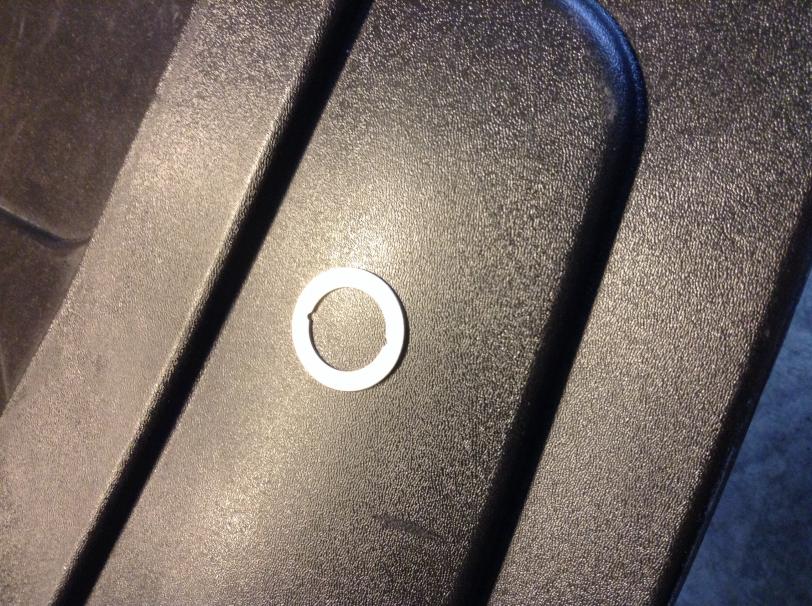

I changed out my master cylinder resivoir with a kit from AB, all went fine till I went to reinstall. I have a metal oring and I am unsure where it goes. The kit came with 2 rubber orings and 2 grommets for the resivoir to sit on. Any assistance would be greatly appreciated. I am hoping the attached pic helps someone assist me. Thanks in advance.

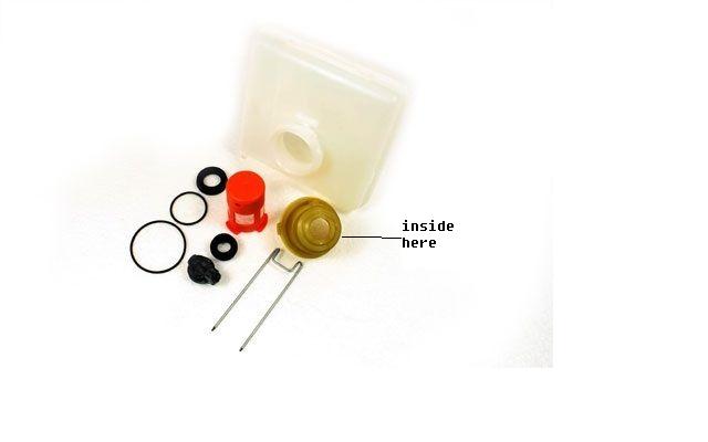

ok.. I just do the same for my disco and as long as I remember it goes inside the yellow plastic,, see the pic... first goes one of the o-rings, smallest then
the part that you ask for ...
